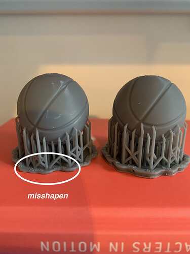

I’m experiencing print failures when I print multiple parts on the entire buildplatform.

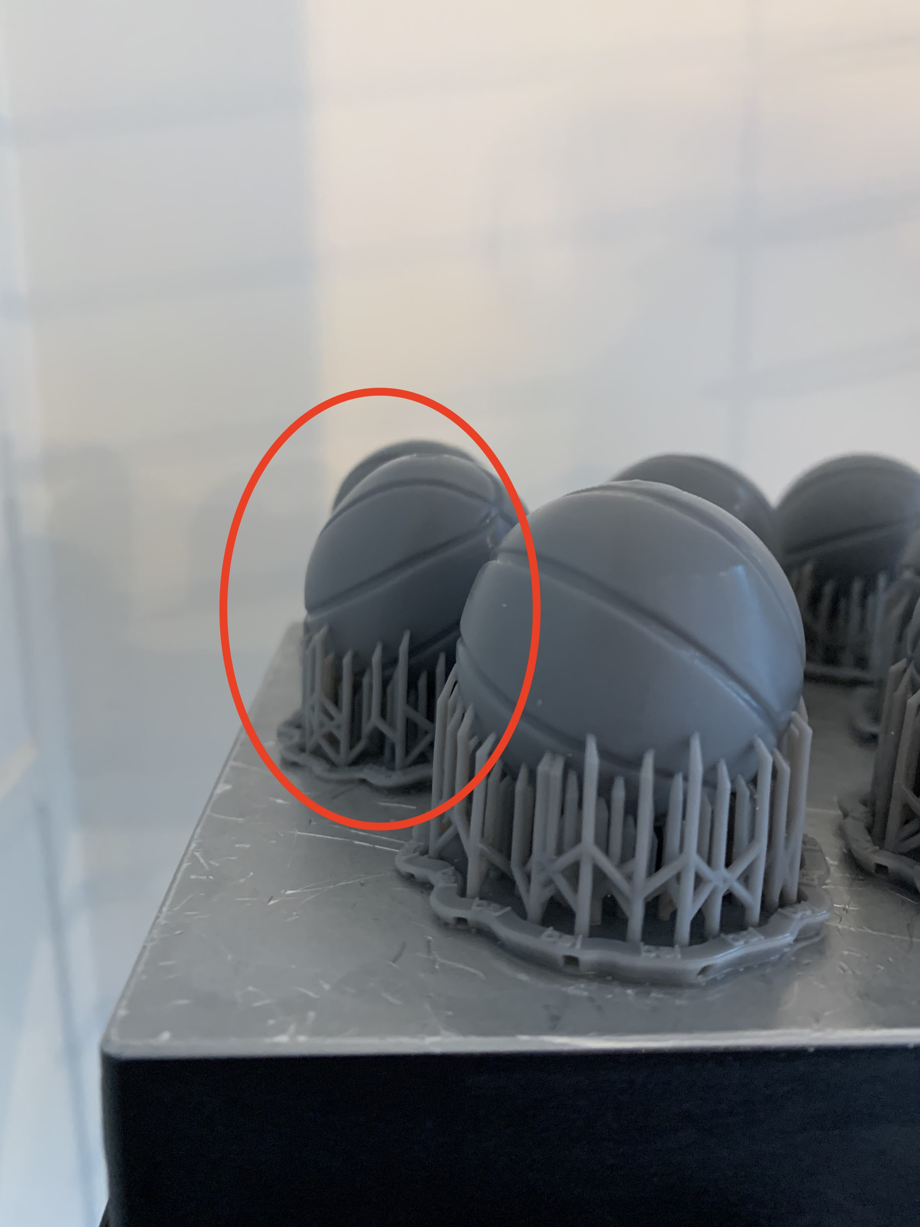

For example a sphere becomes elips / egg shaped
5 of 6 identical parts are perfect, 1 is distorted.
Most issues on the same place (in the middle of the back side)
Tested with different tanks and different resins (v4)
I always use a full raft, and the raft isn’t perfect printed, looks a little bit melted.

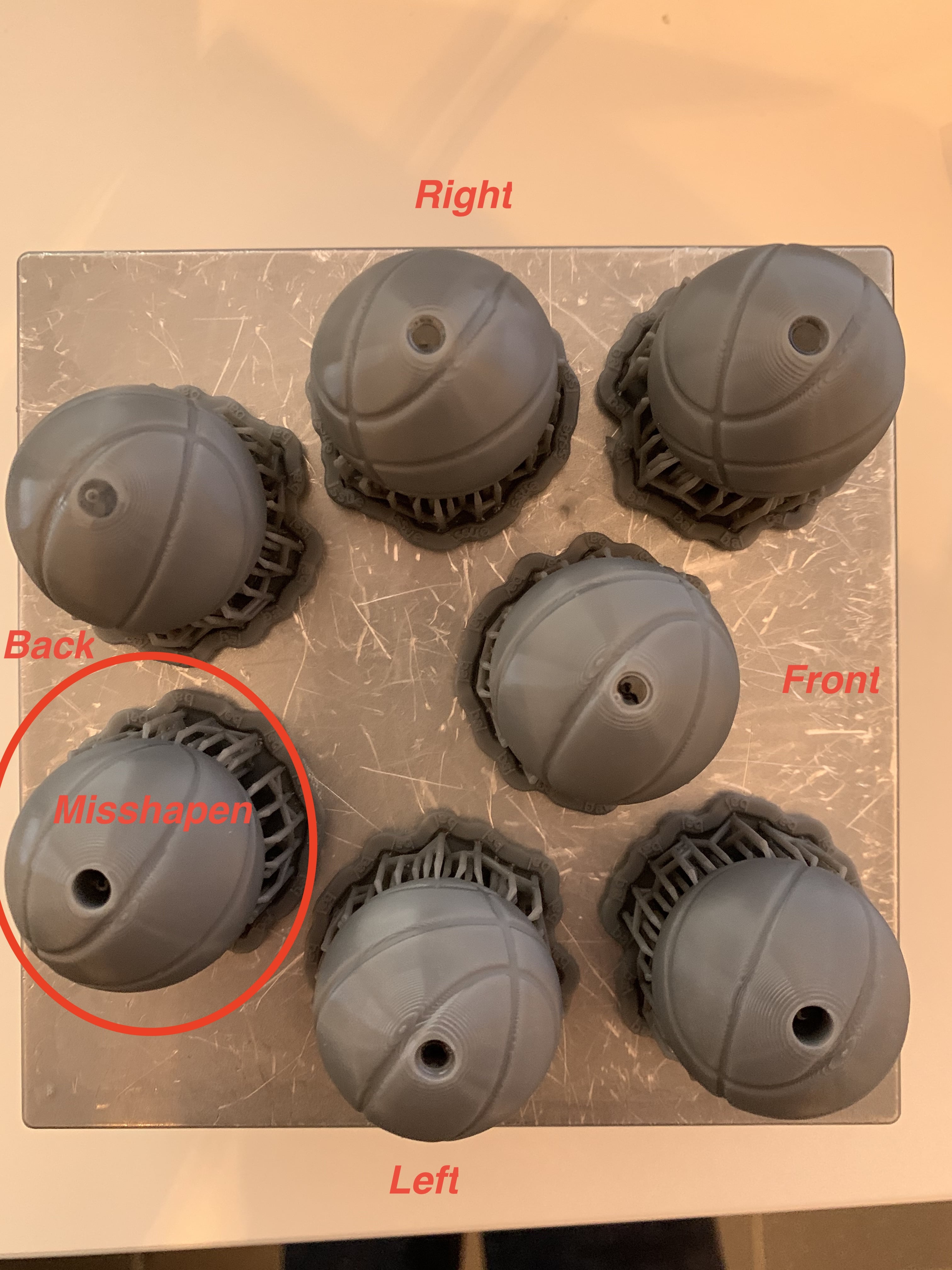

Identical mesh /supports placed @ different places on buildingplatform
mr81
February 1, 2021, 8:52pm
11
I also tested today to reprint only the one who failed on the same spot without the others.
This print was also misshapen.

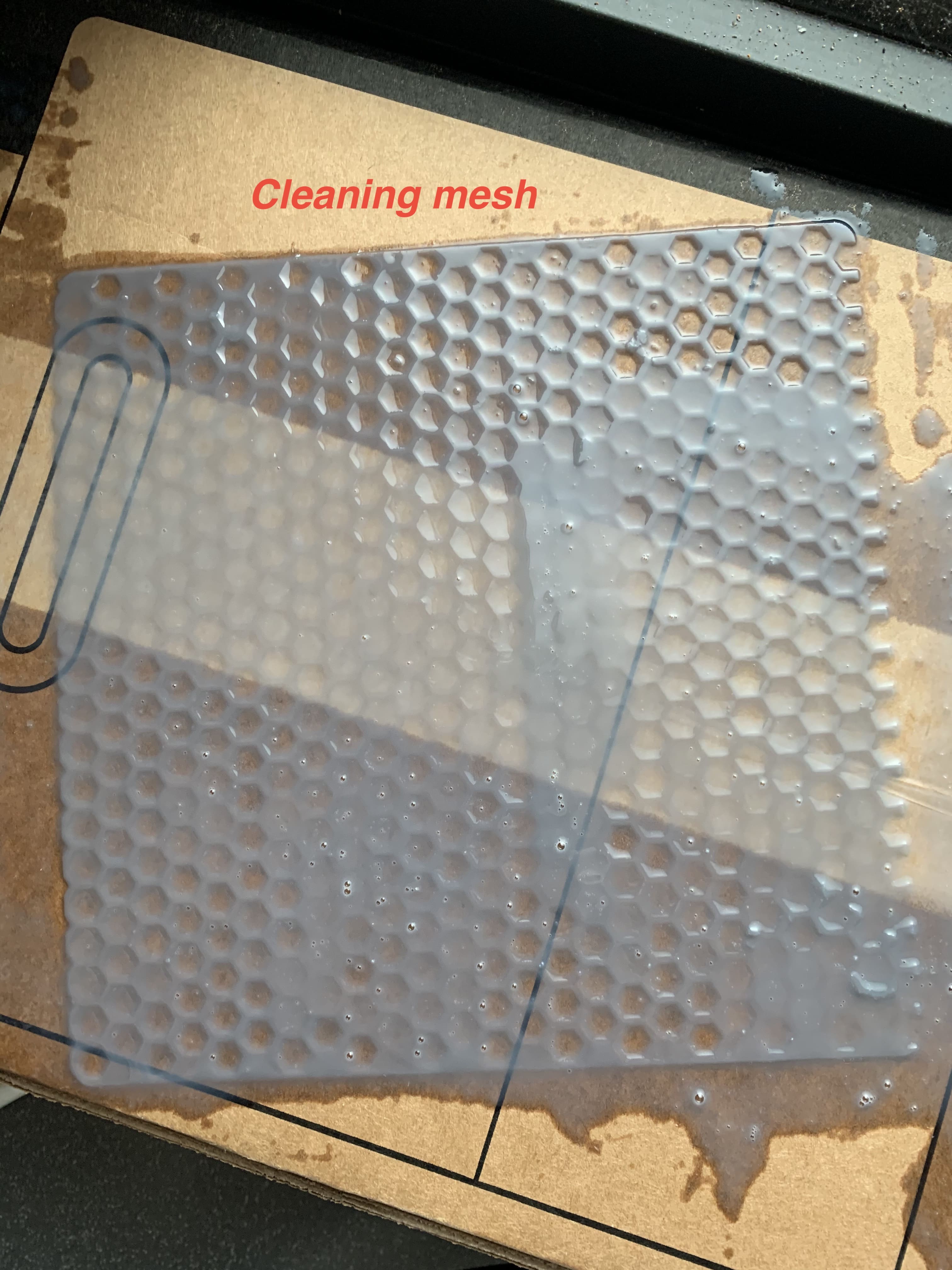

Did a cleaning mesh before the reprint, but it didn’t fixed anything.

What is the diameter of the ellipse, vs. the spherical good prints?
Perhaps it’s an overcuring problem? I’m amazed the print isn’t failing.
they where printer at the same time - orientation, axis
the two prints that failed to me so far, were all the “corner” or “edge” prints on the platform.

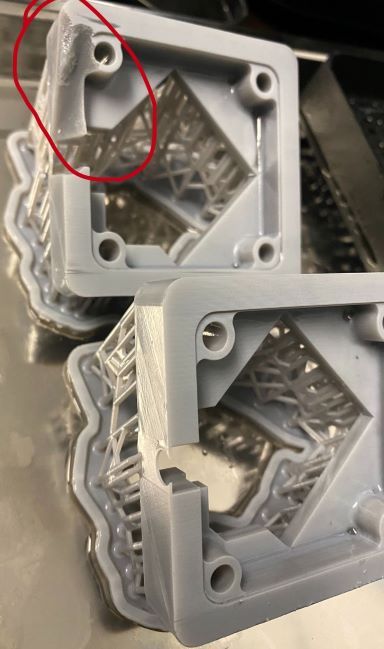

It look likes your raft is fine and but there are parts not printed.
I think this is an other issue.
You should maybe try a different orientation?
I printed other parts after that (ran a 12hrs print) and two parts came out with similar problems
by the way mines were printed on a 3L

I haven’t noticed any issues on my machine that are as extreme as yours. However I have noticed that when batching multiple small parts in Black resin, I do tend to see failures around the perimeter more frequently than in the middle especially if I have a full build plate.
I’m guessing this is maybe from non uniform peel forces across the film.
