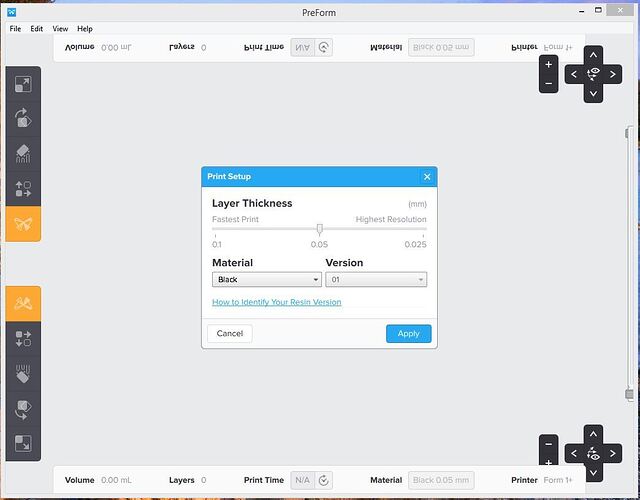

For me 1.9.0 has video issues too. While moving my mouse the whole windows seems to flip upside down and back, for me it is almost unusable. Still checking if there are any driver updates available (intel igp). Hope this get fixed
Edit: I took the time to make a screenshot, this is when i start preform, every item in the screen is duplicated and mirrored upside down. While working on importing stl’s and generating support it will almost Always flicker between normal and upside down mirrored and only sometimes both.
Using 8.1 64X with an old onboard intel hd graphix card on my laptop with the latest drivers and updates.
