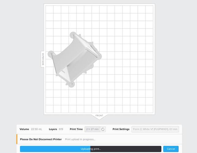

Hi,
We have problem to print from multiple PC’s
Connection to printer is ok, latest firmware updated.
Its stuck forever on “uploading print…” screen, see attached image.
Regards,
Dima

Most of the time, uploading issues are due to your network. Have you tried plugging a computer into the printer directly? If it gets stuck at about 50% then it’s definitely a network issue.
The problem solved already, just replaced network cable ))
Very strange, cause ping and printer connection works fine.
Thanks for your answer.
