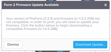

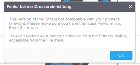

Downgrading to Firmware rc-1.3.2-258 and PreForm 2.2.0 did’nt change anything.
It only opens a new issue, when I try to upload new files:
With PreForm 2.3.3 I see this message:
And btw: Yes, I opened a support ticket.
Thanks for opening the support ticket, Schoner. It sounds like your printer may be experiencing the brown out described above, so the team will be glad to help debug that for you. We may need to get you on a different PreForm version to be compatible with firmware 1.3.2.
