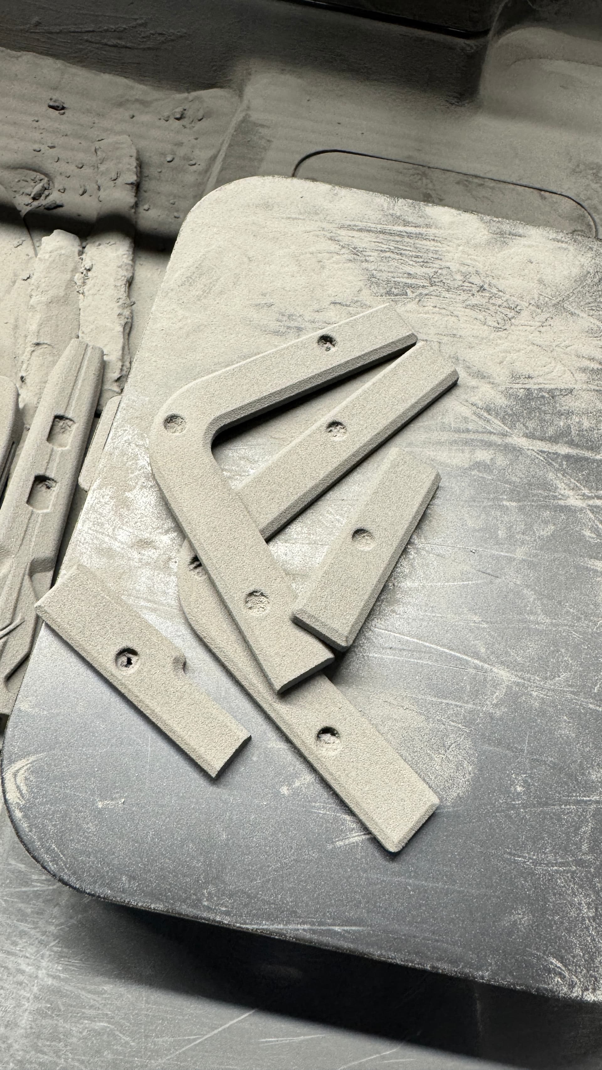

This has now happened a few times with this last print really starting to annoy me… especially when trying to print a taller part and it cuts it in half ruining the job.
So here is the sliced print and as you can see this is a 15 hour and 42 minute print
Got a notification not even 8 hours later saying “Print Complete”… (Note: before this the Timeline showed that the print would take up until 4am…then all of a sudden “Print Complete” and the timeline bumps back to where it stopped and acts like everything is “Good to Go”)
No error message…no Abort… just a “congratulations your print was a success”…
Again, very annoying as the taller part was cut in half and these are the kinds of things that has stopped us from printing larger parts in the Fuse versus smaller rows of parts. The risk and the gamble is just not worth the reward…

She’s Back… Just had a random “Print Complete” at only 2 hours in to a 6 hour print… Started cooling with a “Congrats” jobs done…
We all seen this before so Formlabs…please kill this bug again.
Just lost another $200 in material + labor. The gamble we play with SLS and this system unfortunately… :-1:
Was running fine the past few weeks prior at least.
