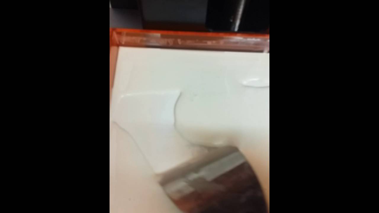

So, just (almost) finished a 4.5 hour print, all was well but 10 minutes from the end… the print completely detached from the supports! Not sure if this was because it was too heavy, not enough supports/contact points too small or the huge build up of particulate on the bottom of the vat. I’m running the same print again, max supports and .6 contact size.
You can see the particulate build up here:

Success, sort of. Got a complete print, same setting as before. There is a definite loss of quality toward the end of the print as the ceramic material is settling on the bottom of the vat. I printed this at .1mm just to get the job done as quickly as possible. Perhaps if the wiper was able to stay straight the resin tank would have remained clear of particle build up longer, but in my experience the wiper needs to be removed as the resin is too thick (also the particles would build up on the left and right side of the tank in a much thicker layer, I would imagine this would also cause issues with the wiper).

The material is very dense - if you check the link to the youtube video you can see how thick the deposits of ceramic powder are on the bottom of the resin vat. The tech support told me they printed with the wiper attached, but it kept fouling up the build plate so I removed it.
