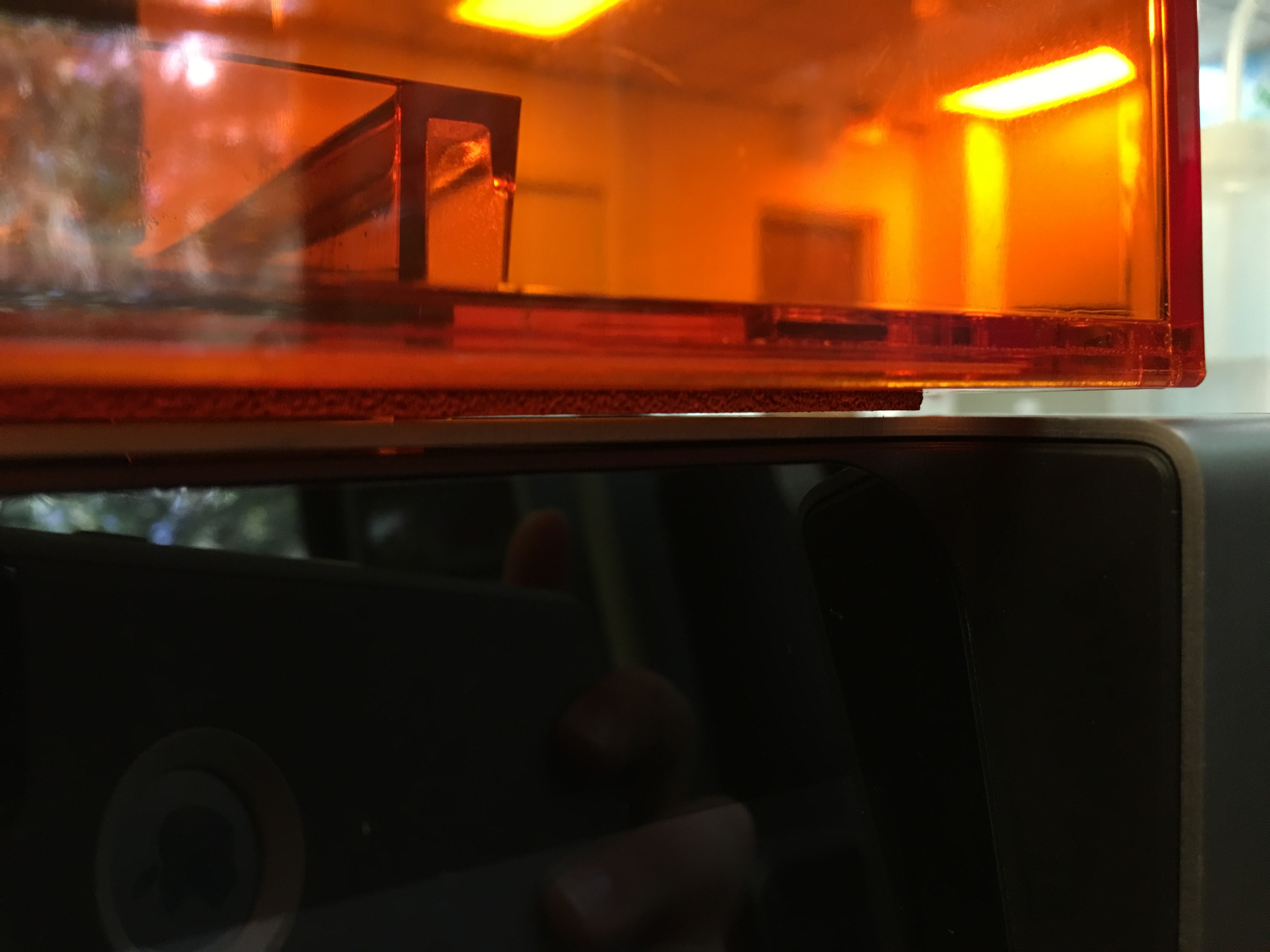

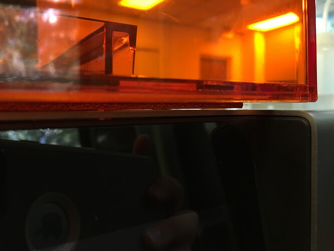

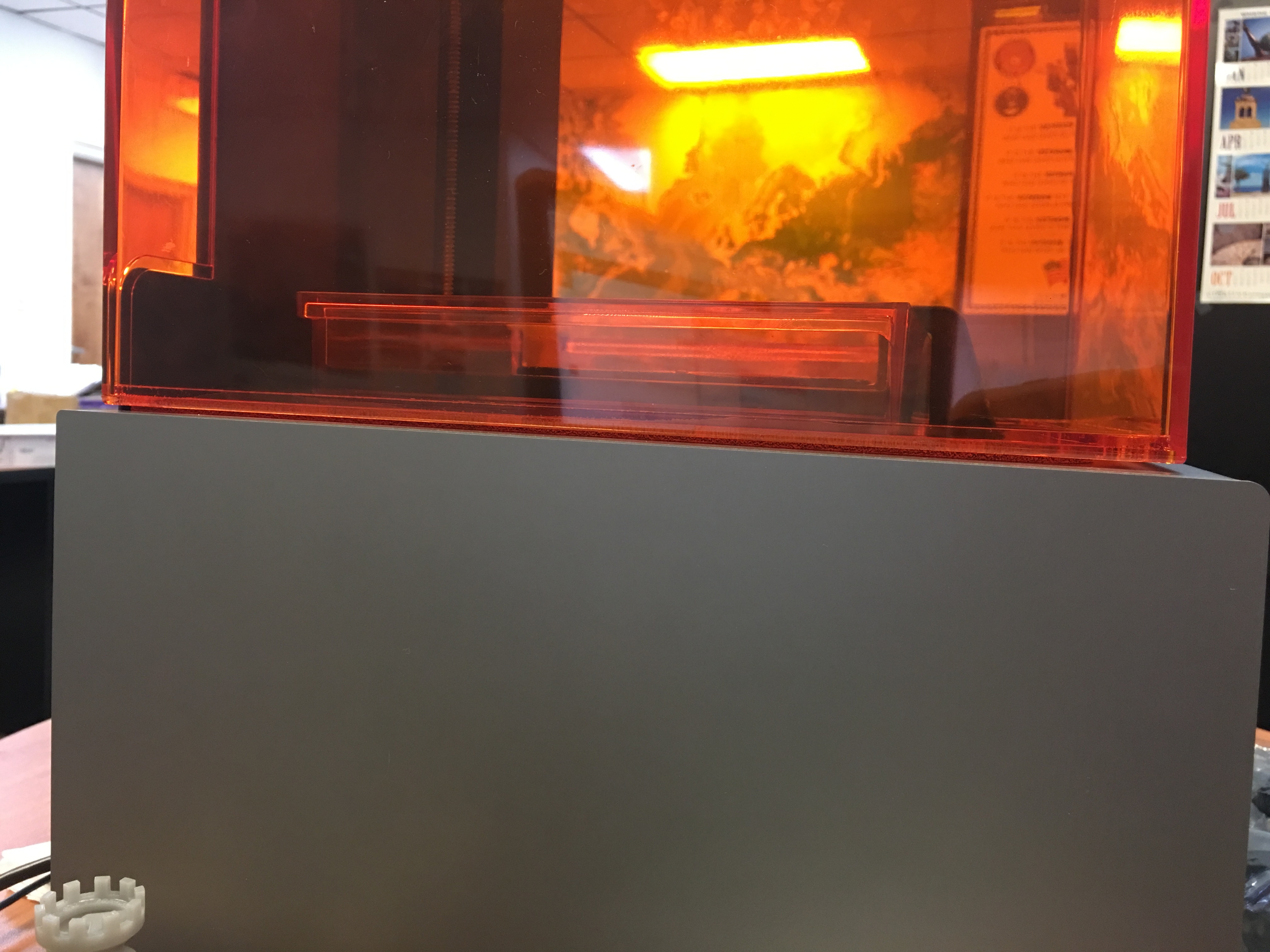

Does anyone have issues with their Form 2 lid? We just set ours up the other day and noticed that the lid isn’t on straight. It’s causing issues when closing the lid and not being detected closed until a bit of pressure is applied down on the lid. The right side seams even, its just the left side that isn’t level.
This is the left side (notice that the lid is touching at the back of the printer.
This is the right side.
Since the left side is so low, there is a gap when the lid is closed on the right side.

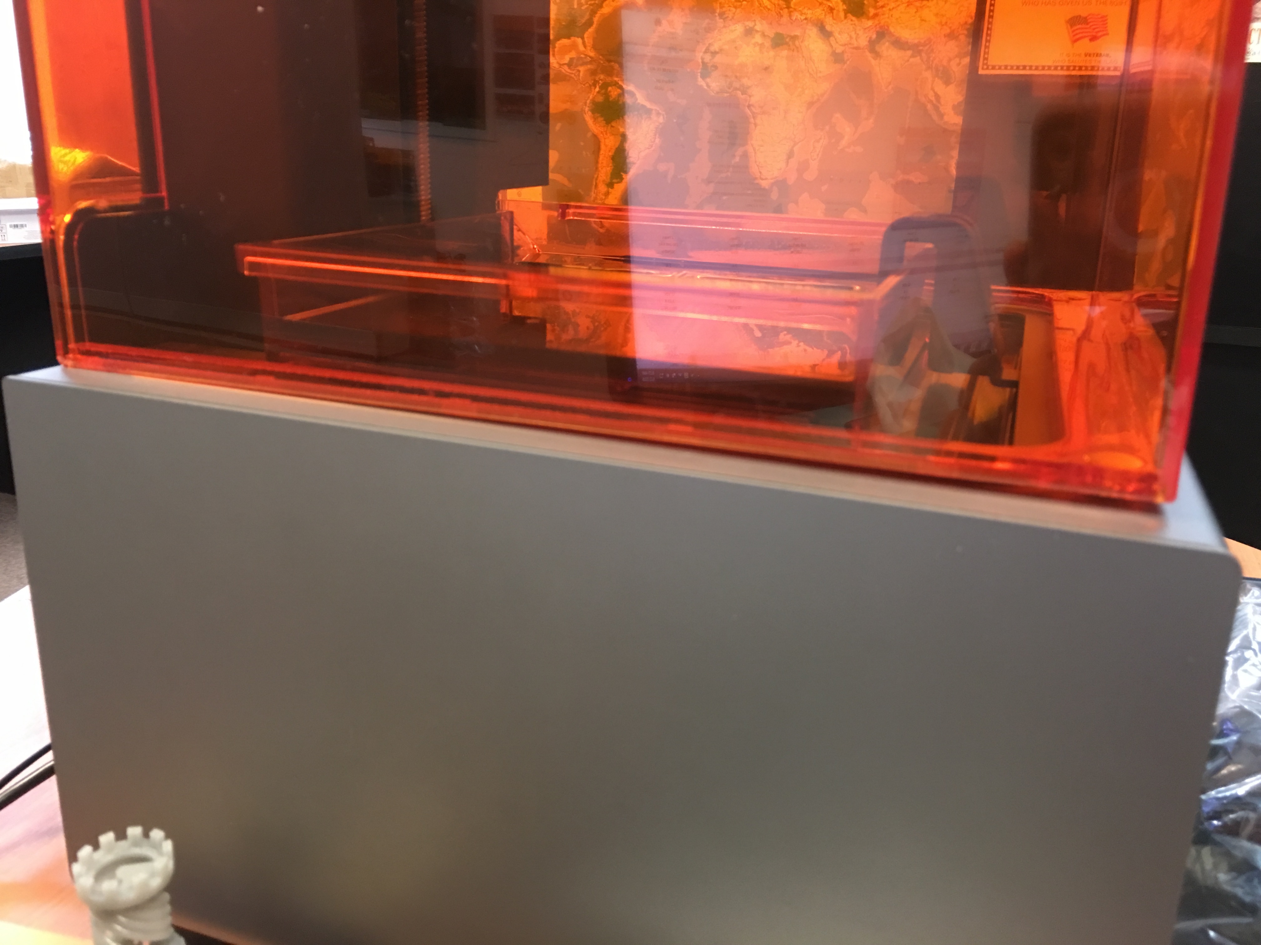

Here is the lid after following Formlabs instructions
No longer having any closed sensor issues.
