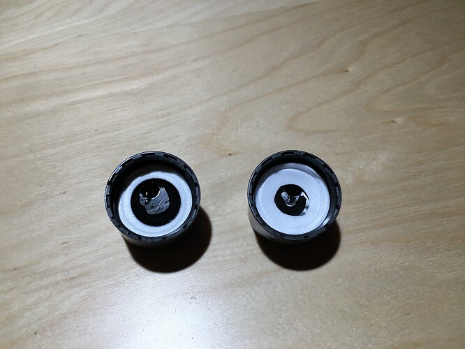

Try unscrewing the cap and checking the white pad inside the cap. The center of the white pad should have a hole cut out. It should be at least 1/4" in diameter.
I had a similar problem, only a few drops would dispense on one of my early resin cartridges. The hole was only about 1/8" dia. If you folder it in half you can cut a pretty round hole with a pair of scissors. After enlarging the hole put the pad back into the cap and screw it back on the cartridge. Hopefully this does the trick.
Picture: Left newer cap, Right early cap after increasing the hole size.
