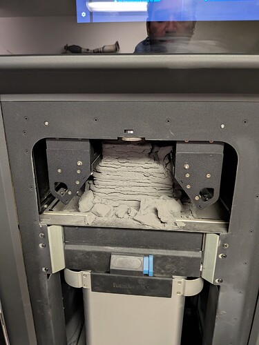

I started a Nylon 12 bed temp tuning calibration print yesterday. I got the text that it finished early this morning and when i got to work the machine was in a Primed state and the camera feed was black. I unprimed the printer to open the door and found this….

Woah, that’s not good. This has never happened to me. Are the bed temp printed plaques in there?
AFAIK the printer doesn’t allow you to prime after a completed job until the chamber is removed and replaced. I don’t think the printer can be primed remotely either. This seems like a really bad firmware bug. My totally uneducated guess would be that it’s related to the bed temp job, and potentially OMM (is this printer OMM?)

Yes, all the parts were in the cake and the temp shield on top was forced into the frame of the machine and is warped from the force. The quarts bulbs look intact but are covered in powder. I have cleaned the machine but havent touched anything other than lowering the print chamber so i could remove it.
i am about to start digging into the machine to see if i can find fine detail logs to see when this Priming sequence was initiated and hopefully if it was initiated by touch screen interactions (unlikely since no employees were clocked in during the time frame) or by the software on the machine.

Holy cow man, that’s crazy! I am keenly interested in what caused this. I cant imagine what it would look like if you had a full chamber in there.
The top heat shield saved my butt. It stopped the smaller plates from getting smashed into the glass covers for the laser and camera. The top heat shield is deformed from holding back the rest of the cake, it caught on the rails above the quartz tubes.

After reviewing the logs, we can see that the print finished at 04:50 UTC on October 31st, and then priming was initiated from the UI at 08:25 UTC. From what we can tell, this wasn’t an automatic action triggered by the printer’s software, it looks like it was likely a physical press on the screen that kicked off the priming workflow. That said, there’s still a small chance this could be a hardware issue or something else unexpected.
You mentioned no one was around when it happened. if that’s the case, it might be worth double-checking if anyone could have passed by or interacted with the machine around that time. We’ve seen very rare instances where ghost touches can occur due to display issues, so we’re not ruling anything out completely yet, and will continue to look into it from a technical perspective.
