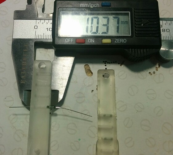

Was initially pleased by new preform, esp support for high res monitors, however the first print with the new firmware and preform is overcured.
I immediately noticed how much harder it was to get the part of the supports than the same part printed yesterday, and then i noticed the fine holes were constricted, and of course when I put the vernier calipers to it, the dimensions have swelled. The face being measured is supposed to be 10mm…
See the comparison pics below, original part printed yesterday shown first, with two reed switches inserted, and dimension being in quite close tolerance to the specificed 10mm. Compare with the second picture showing the exact same part printed with same supports. That’s now bloated, and the holes are smaller so that reed switches will not longer fit.
I’m trying the same print now with reverted preform 2.9, but if that doesn’t fix it, I’m not 100% sure about downgrading the firmware. I have wireless enabled, and the form2 automatically updates and doesn’t give me the option to skip firmware upgrades its downloaded.
Does that mean I’ll have to disconnect it from wireless if I want to downgrade the firmware??
I downgraded Preform and reprinted the part last night, exactly the same result; part was swollen, holes too small and dimensions increased… So this morning I disconnected the printer from WIFI and plugged it into USB, then downgraded the firmware to 1.9 and reprinted the same part again.
This lastest part is now back to tight tolerence dimensions, and is again as easy to remove from the supports as it was previously.
See that the 10mm face is now measuring very close to 10mm, and the reed switch holes now fit the reed switch again.
