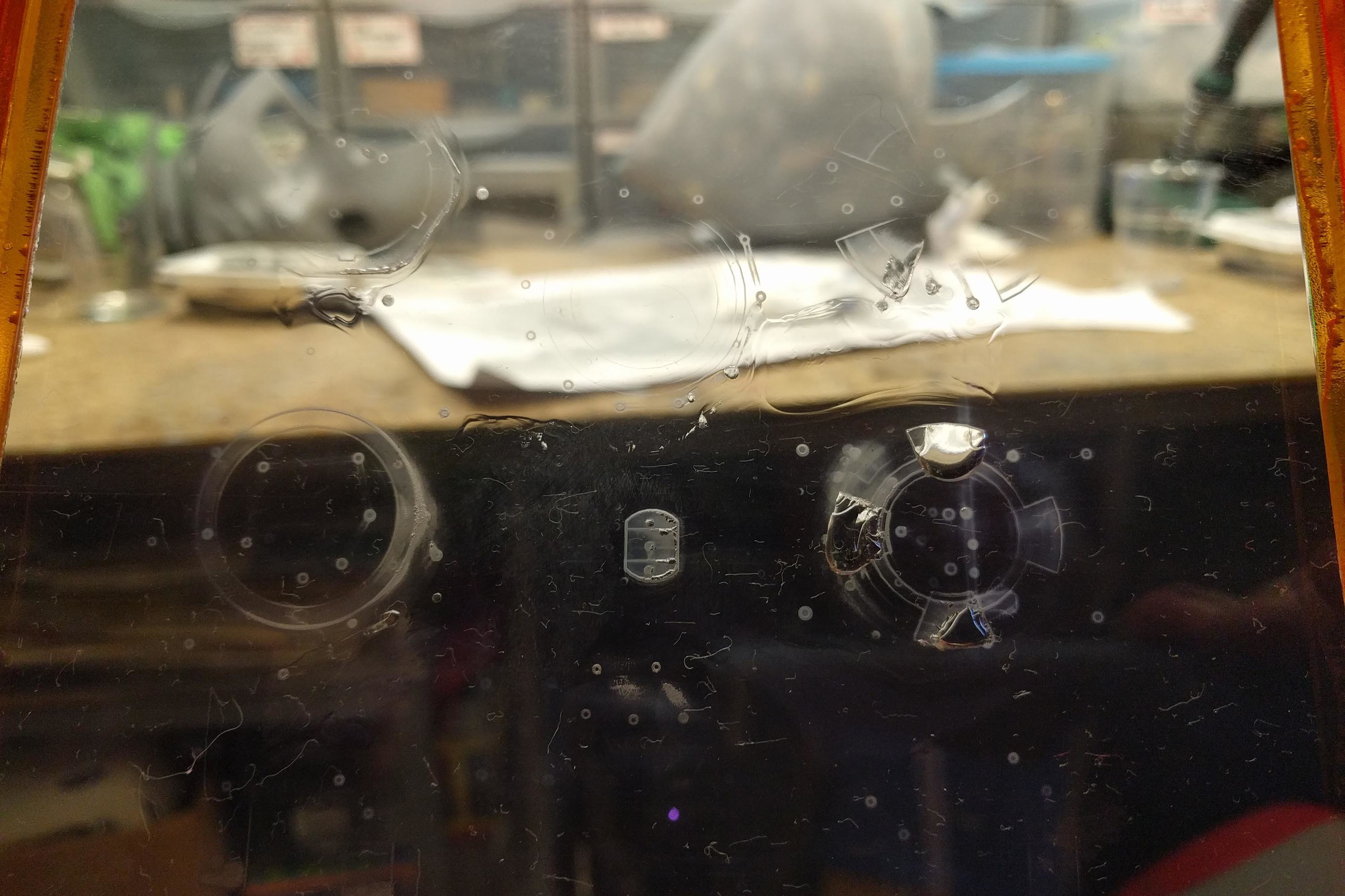

I found more than half the items had been pressed so firmly into the PDMS that there was no way to get them off without losing some silicone. And how!
The odd thing is that the print apparently started out okay - the shapes you see dug into the PDMS are NOT the bases, but cross-sections of the print and supports well along the print. Around the edges of some of the gouged areas were what is called “crazing” in acrylics - a cloud of microscopic hairlike artifacts radiating from a point of undue stress. This indicates to me that the prints must have been pushed into the PDMS REALLY firmly. I’m at a loss right now, both diagnostically and, unfortunately, financially. This was the tray I had JUST received as a replacement for an earlier issue (bad chip). Really trying not to take this personally. Anyone in Formlabs or otherwise have any ideas about this?

Did the printer some how start to print the models upside down or mirrored where the support base is on the opposite side? Looks like it started with the last layers first.

It’s a Form2, and they all printed correctly from the start with the base against the build plate:
I looked in on the print and noticed that the object at the center of the photo would stay in the resin tray when the build plate lifted. You can see the PDMS severely and securely stuck to it from when I tried my best to remove it. :frowning:
Almost looks like the resin was over exposed which would cause it to stick to the pdms. Maybe the exposure was changed or defaulted to a wrong setting ie black or tough that use a higher setting vrs the gray you have?
