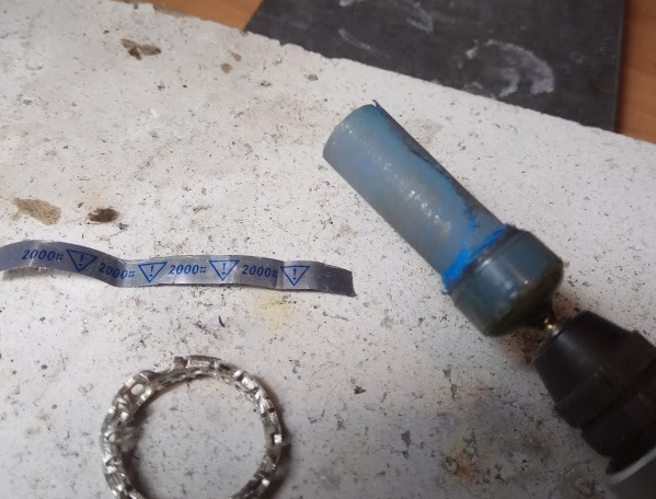

The following are the tools I generally use
New photo by Lai Rick
Slotted Mandrel I do not often use, only in very special circumstances, my sandpaper volume run out, forget the replenishment, no I want the thickness #, I will use Slotted Mandrel, using Slotted Mandrel is not easy, you need yourself Cut, glue, test, modify … _ Oh, he spent my time too much, I hope that time to design work, but sometimes can really help me some busy, little busy.

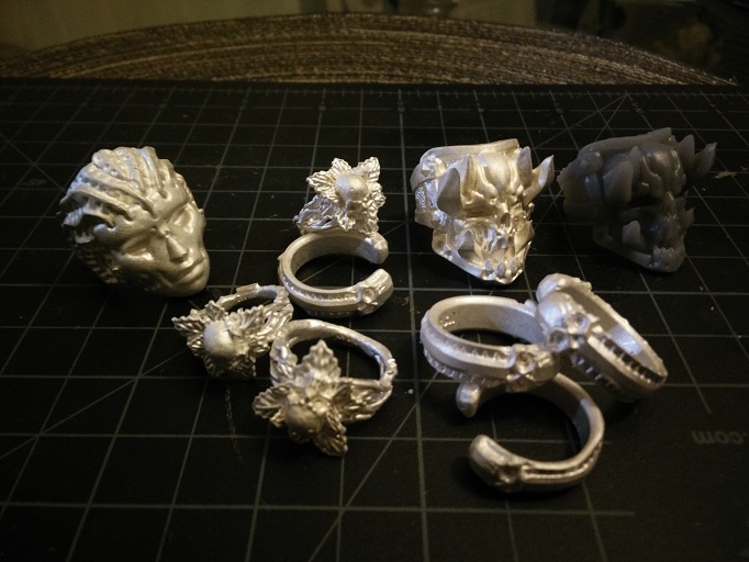

I’ll be casting a run of about 18 items here shortly, divided into four flasks.
I had these cast locally then cleaned them up and lightly polished after patina.
Results!
