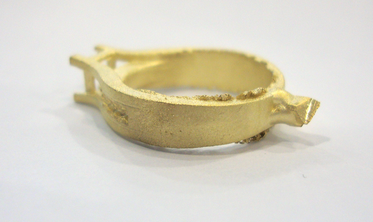

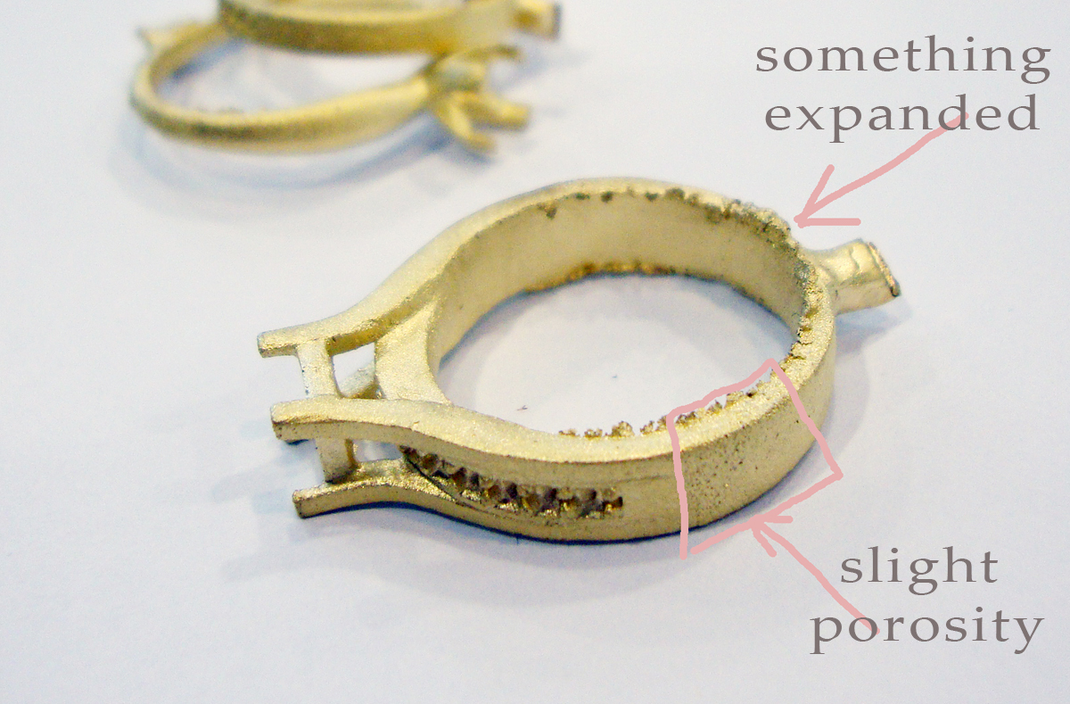

Today have received almost clean pieces in normal casting procedure (as usually is used for gold in lost wax casting)
but the prints have expanded in some bottom areas of rings (maybe too much water or too small curing or sth else).
Easy to file the extension, but want to avoid that and get just perfect clean piece. Tomorrow can send you some pics.

so result can be different: eg: too much water = expanded resin, because investment is not rigid enough.
I got this week : silver ok, yellow gold expanded,
white gold not expanded, but to repair all wholes in cluster ring) - just drilling to do - but it should be opened.
There is no tragedy, I can work with that. There is no need to overweld nowhere, - happy with that.
So all pieces are solid (really small prosity) and require just some filing and some drilling.

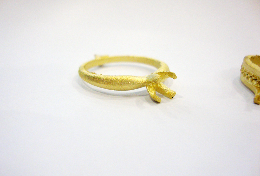

Hello Kristioan
I am sending you some pics of rough casting
this solitarie is fine
fortunatelly expanded areas can be treated with filing and other abrasives.
All prongs exist. hahaha. happy about that
about silver casting, 2 rings are fine. No expansion. like magic. Don’t know why.
One piece from yesterday is for repeat. All the wholes in cluster ring are closed.
Almost everything is closed in that ring.

It looks like investment cracking due to the different expanding rates of the resin and investment. As the investment cracks, investment particles can cause what looks like porosity. on the surface (most of the time they are internal). This condition will come up sometimes and we have not been able to eliminate it completely.
The best thing that I can suggest is to follow the Formlabs investment rules completely, especially the dwell time at the low temperature.
You might try AstroVest investment, It is almost identical to most dental powders and a lot cheaper. than any dental powder I have seen.
