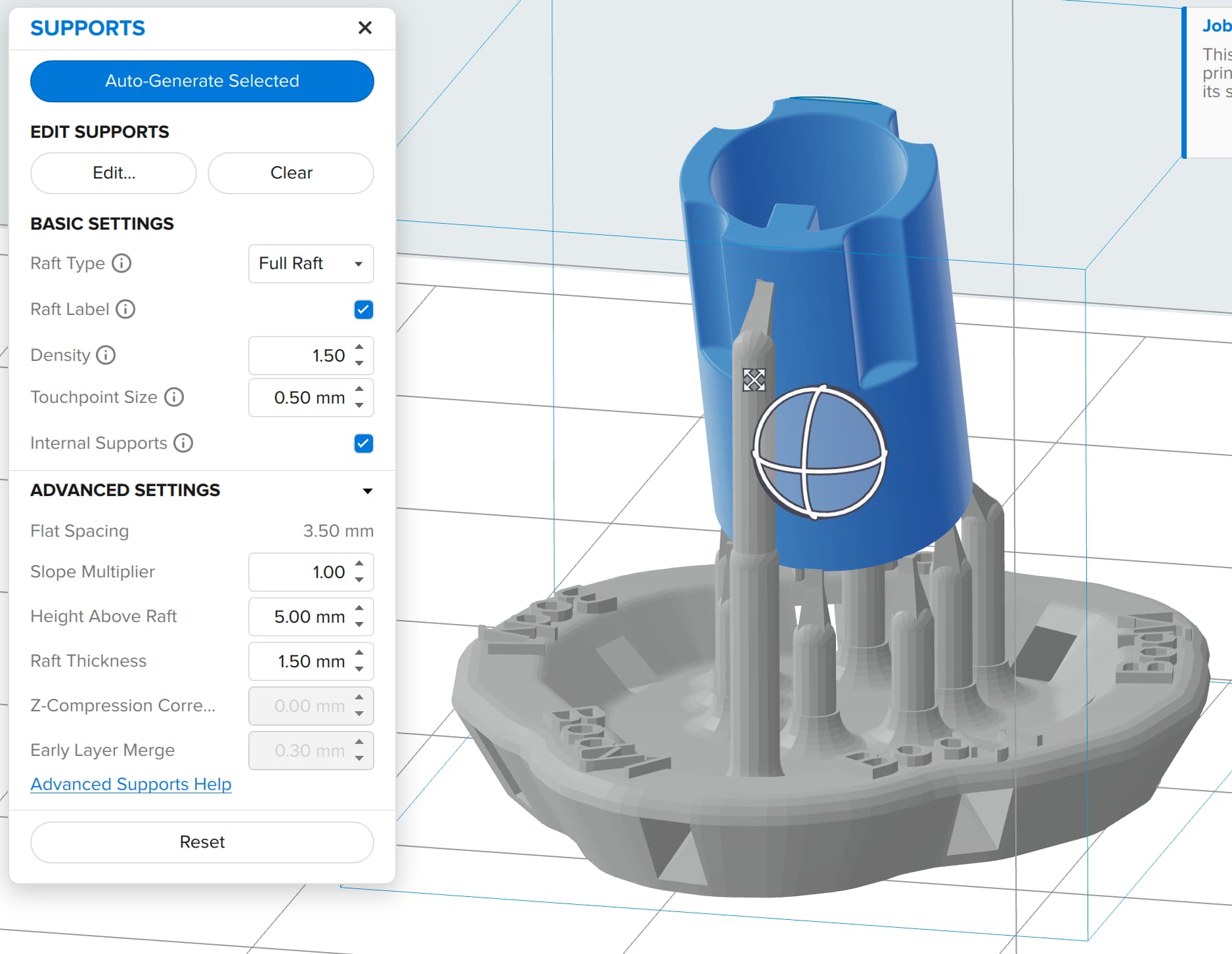

Why does this not stick to the build plate?
I’ve printed several cartridges of Tough 1500 in a row without any issues, until now – when trying to print the simplest thing, fully (150%!!) supported on a full raft it just fails.
I’ve tried twice, different positions and fully cleaned up and filtered the resin tank between runs, but no, just will not stick.
Is it too small or what’s going on?
Here’s my print file:
Failed Print.form (348.5 KB)

But isn’t it strange that other models I regularly print directly on the build plate stick, but not the model above?
Hi @Reine,
Testing out the same print with a different resin type sounds like a good plan. It is definitely strange that this only seems to be affecting this particular model. The small raft footprint shouldn’t have an affect on the adherence, but perhaps that could be a factor as well.
I printed it twice with Clear yesterday and it came out fine both times.
