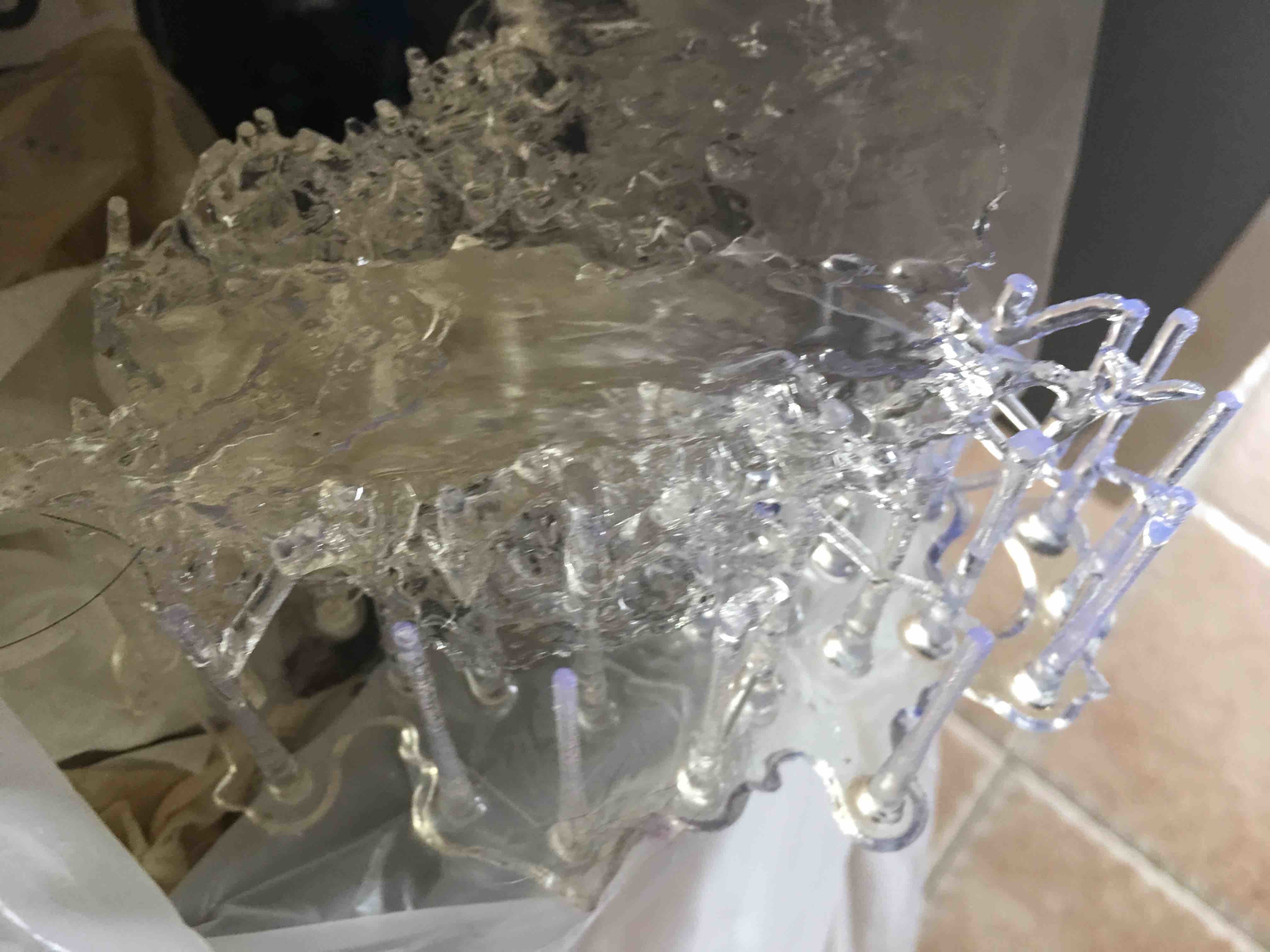

WHAT? first time print get my resin tank burned!
Hi,
I bought a Form1+ like 2 years ago, today i picked it out on desk with a new resin tanks and print with V2 clear resin with 0.2mm layer height setting. It was terrible clouding then i halted the process. i saw visible dots suppose to be support beams when laser forming it left some permanent marks on the silicon.
Very frustrated. I notice that recent firmware update might have increased laser power significantly, and hope this report will get your notice and drive you double check your print settings.
The Form1+ printer’s mirrors are exposed to the environment. They will get hazy over time due to condensation of volatile organic compounds in the air. These VoCs collect on the glass. Based on my experience, the mirrors need cleaning at least once a year. Maybe more frequently depending on the environment. If your Form1+ is 2 years old, it is long past due for a mirror cleaning.
The problem you have with your print is most likely due to dirty optics and nothing more… You would have gotten the same results with any resin.
Also, the silicon surface of the tank bottom is “sacrificial”, it wears out over time because every peel cycle removes a little of the material. Supports will cause pitting just like you show in your photo. There is nothing unusual about that, either. I’ve had tanks that looked like they’d been peppered with a shot gun, and they still worked just fine.

I just printed out a couple of pretty tall parts at 200 micron setting for clear resin with no noticeable clouding.
The spots you have are probably from the dirty mirrors like Randy said causing the supports to break off onto the pdms where they had repeated exposures on them where resin was fused to it.

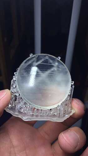

I have read a pdf guide for galvo cleanning. I could not remove the galvo block so i cleaned first mirrors while they are on the frame. now i finally have printed 1500 0.1 layers.
It looks like a have a scratch on the second (small 45 degree angle) mirror. and resulting a minor trace on the print.
now i put on a new tank and it prints like before. and i will look into the flare later. Thanks for everyone.
I’d recommend working with our support team for mirror cleaning and further troubleshooting. Some of these processes can be a bit challenging and using the wrong technique can damage the printer. We’ll work with you to identify any issues and get them corrected.
I think it’s fixed. look at the lens it printed after galvo has been cleaned. although while growing higher some residue grows due to flare, i think i can leave it for another 6 month.
