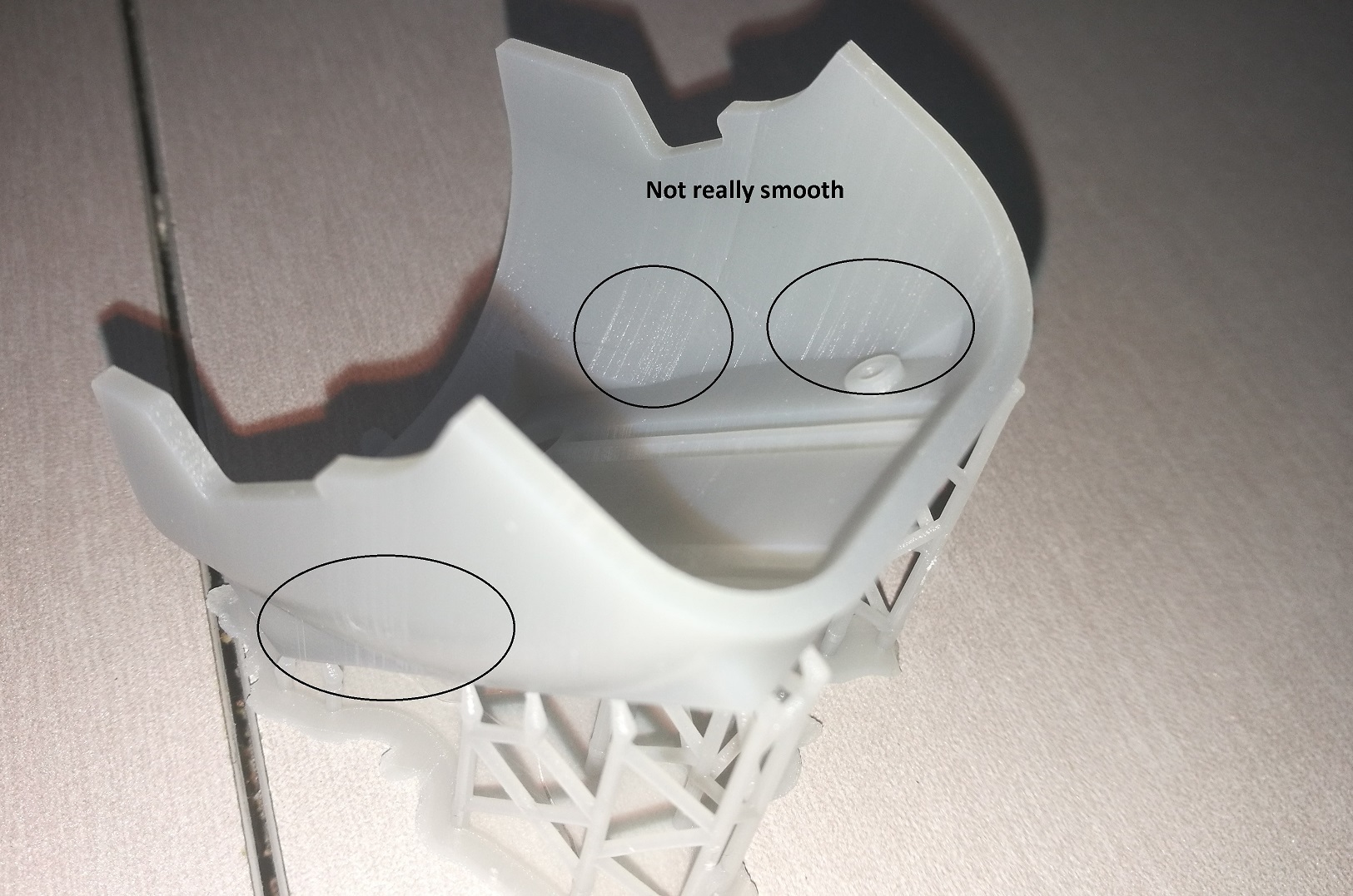

What do you think what is the cause for this issues?
Hey folks,
Im beginning to have printing issues with my Form2…here are some pics:
The resin is filtered with 190nm mesh paint strains
The tank looks very clear
My idea - maybe the main glass? I tried to clean it up with a IPA-99% and there are whitish stripes - im afraid of polishing them away with paper towels or using aceton for cleaning, still waitung for the delievery of PEC pads.
Du you have any thoughts?
Edit: Standard grey resin, 50nm print.
My grey resin looks much more brighter than the sample from Formlabs… is it expired??
I’ll let Formlabs post on cleaning the main glass but if there are any streaks that’s your problem. For what it’s worth it may not be glass and IPA may damage it. Acetone is a super bad idea because the outer edge of the glass is sealed with rubber.
I use regular glass cleaner for the main glass with a good microfiber cloth. No ammonia.
Edit: Looked back at the print and the areas that aren’t smooth look like an optical path issue. The main glass isn’t clean or is damaged from IPA.
Good luck.
For your print I would raise the height to 8mm which will give it some more space from the base. There’s a line on the bottom due to how it changes printing after the first 5mm which have a higher exposure.
If you have a hole in the print then that’s likely from a particle of dust or something like that.
If you have noticeable streaks on the glass then that can affect the print as well. IPA is safe to clean glass but it would be better to use Novus with Pec pads. IPA is not good to clean the acrylic cover or the acrylic tray though since it can break down the plastic. If you get distortions or lines near the top of the print then that can be caused by not having enough supports to stabilize the print–as it gets taller it can flex more so it can require more supports to keep it stable.
It does look like there could be something obscuring your optical path. Streaks on the mirror can modify the exposure of the laser and cause issue. I’ve gotten in touch with our support team and one of our members will reach out over email to help troubleshoot. We can also guide you through the correct steps for optical window cleaning.
