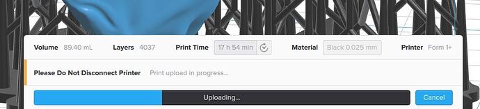

I use form1+ to print high resolution(25 microns) print outs, thus the number of layers is huge.
As shown in my screen-capture, the # of layers is about 4000.
The file upload time takes over 50 mins, and I have several times that I encountered “File upload Failaure.” Then I have to re-upload again. This is really a waste of time and resin.
I have a few suggestions and questions about this “File upload Failure”
1) The printing starts while uploading file, if the file upload fails, I have to clean the build platform and the resin tank. It is both a waste of time and resin. Can we have an option button that “ONLY start print when file upload is complete”???
2) What cause the file upload failure??? I can use the same (.form) file to do the re-upload, the 2nd time will succeed. Is this upload file occur randomly??

Would you mind telling me how to upload the file directly to the printer without starting the print? I am looking for this method to reduce risk. I usually just click on the YELLOW butterfly (the upload icon) and then hit the Form1+ button once to have the file upload and print.

Once you hit the Yellow button as long as there is nothing printing it will automatically upload the file just do not hit the physical button on the printer till the upload has completed.

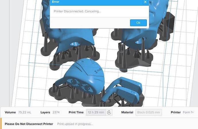

I have tried to use the method that WAIT for the upload file complete and then press the BUTTERFLY button.
I got the following error twice during file upload, the good news is that I don’t waste resin and time to do the clean up as I wait.
The error says “Printer Disconnected. Cancelling…”
I look at my Form1+, the printer scree shows the usual message :“Build Platform? Tank and Resin? Press to Confirm”
Can you give me some advice? Thanks a lot.

I really need help, I have tried and tried again to upload my file. But still, the file upload process is failure. This time, Perform 1.9.0 just simply stops in the middle of uploading? My Task manager shows that Preform has no action as shown below.
I have tried to downgrade to 1.8.2, the file upload still not working.
Then I start to doubt if my obj file is corrupted, so I do the remesh and mesh simplification, and etc. No error is detect in Preform and all other 3D softwares.
After all the trials, it still not working, is it due to my Form1+ broken?
Really need helps. Thanks.
Yours,
Cheuk
Dear All,
The problem is fixed, it is due to my extended USB cable. Please use the original USB cable for successful upload.
