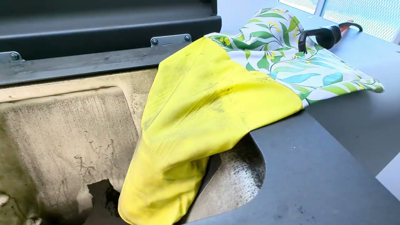

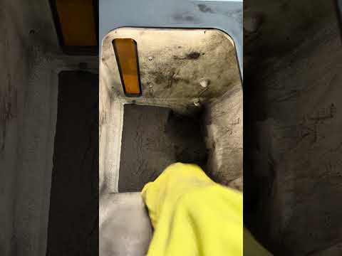

now the vibrator i hope can solve the issue, video at top
it is a 12V vibrator been wrap inside a rubbeer glove for protection, and the glove itself have a rubber band to secure on machine to prevent whole setup slip into the feed system
since i forget to have timer, i now run it 3 second every hour
the material as see at video, it original have 2 big feed cone , print will most likely to fail if all other material won’t collapse and fill the gap
nw after vibrator, it seems help
still under running test at this moment
i will report more after extensive test
it ideally best screw on the hopper but it will definitely ruin the warrenty, so that is why i choose this funky setup
