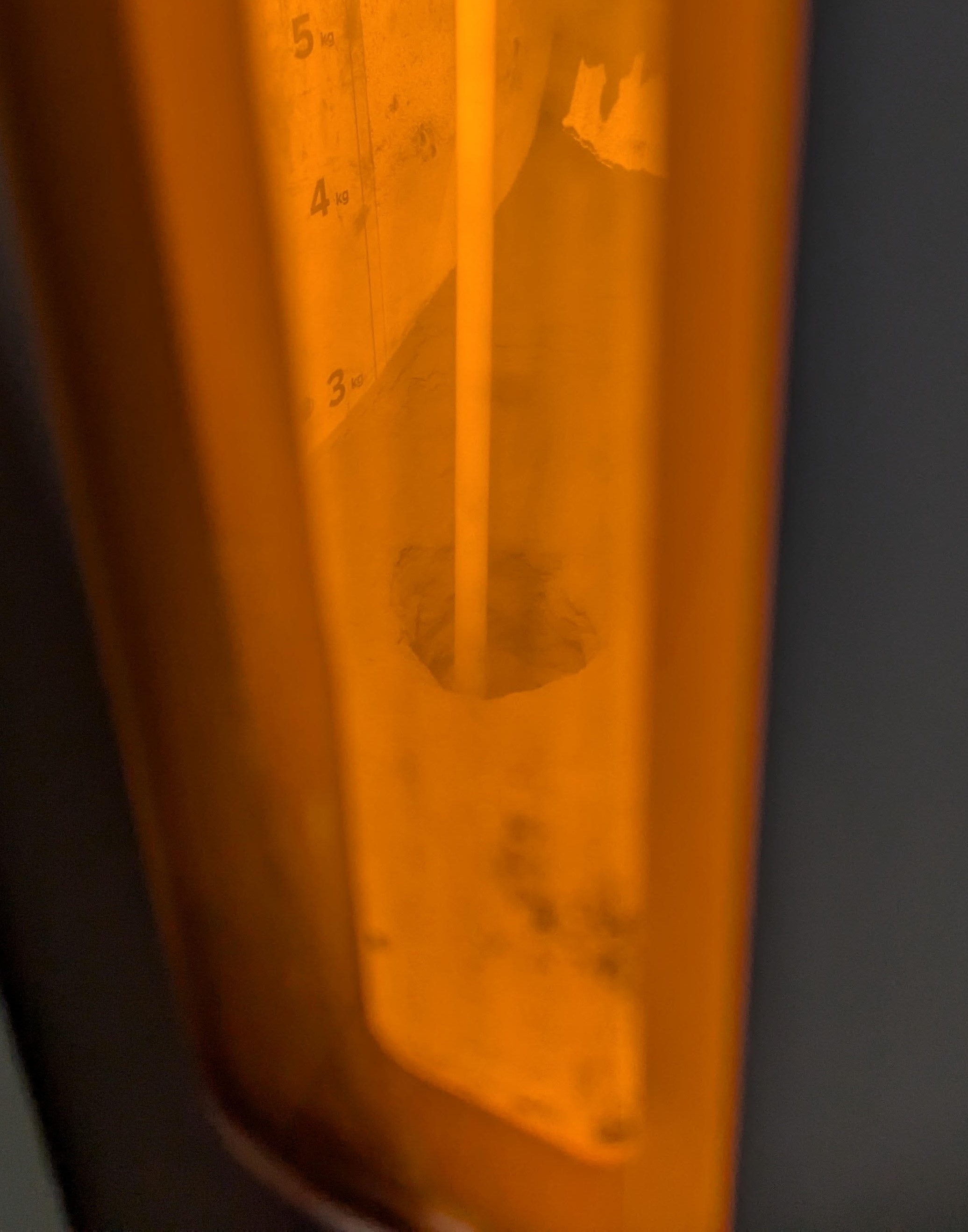

Unfortunately, I’m not able to get pictures of the clumping because it happens at the bottom of the hopper, underneath the bulk powder. I’ve attached a picture that may be representative of what’s happening (but more on what’s happening in the picture in a moment). The clumping results in a cavity in the powder and prevents the material from dropping down into the doser (not across the entire doser, but one side of it) and results in a shortfeed. When I agitate the powder manually, I can feel it drop down as the clumping tension breaks, and then the recoater gets powder again. The clumping happens very frequently, I would say every 20 minutes and sometimes as little as 5 minutes, if I don’t manually stir the powder in the hopper.
Today, we’re trying a stirring device we fashioned (a PTFE stirring rod attached to a motor). So far there hasn’t been a short-feed in the first 60 minutes of the print, but I can see the material forming a channel around the stirring rod, which may be happening underneath as well. That’s the piture I’ve attached.

It looks like the rod might be obstructing the material flow a bit. You might want to adjust the setup slightly to ensure a more consistent feed.
