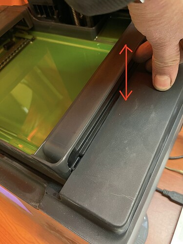

The second question is about installing the resin pan. After installing the pallet on the right side, I have a vertical backlash (you can raise it by about 3 mm), this is normal, or there should be no backlash.

Yes, the tray is a loose fit until you start a print. Once a print is started, it gets locked-in. If the tray isn’t properly-seated the Form 3 will throw an error message and demand that you fix it. So no worries there.

Thank you, you reassured me!
