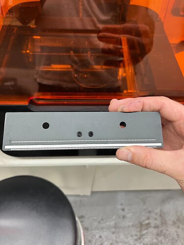

LPU Calibration plate came loose, no idea how to get it back on
The calibration plate that lives up in the roof of the LPU’s cubby hole fell loose and I have no idea how to get it back in place. I can’t even tell how it was mounted in the first place (looking at photos online of it in place, there appears to be nothing holding it there.)
Weirdly, the printer doesn’t even seem to know it’s missing.
i just had a look at mine, there are 4 small plastic clips that keep it in place. 2 on the long side and 1 in each short side

I figured it out. It mounts magnetically.
I just had to swipe the LPU to the side, put a mirror down in the belly of the printer, turn on my phone light, and set my phone next to the mirror. Then I could find where it went and it popped right into place.
It being magnetic also explains why it came loose, I guess.

Was it pretty ‘obvious’ once it clicked in?
My plate just fell off too (I have sent a ticket), but it was clearly held in place with glue.
I had a look and there was no obvious way to align it in the right place.
