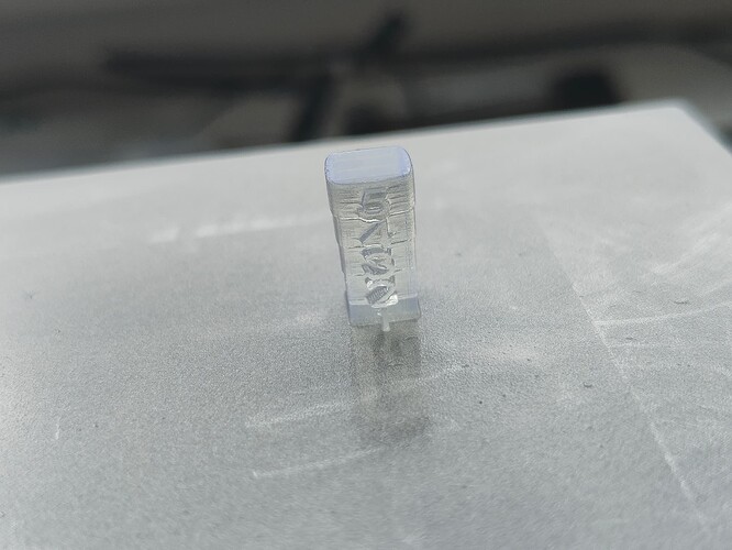

Once you’ve completed those steps, please upload a few photos from the optics test. I’d be happy to take a look at it and let you know what the next steps would be. Alternatively, you can open a support case and have one of our agents assist you with the next steps.

First, I printed out the optics test, I’m waiting for the part to dry, and I’ll send you photos with the results.

@StartLamp I have to say that is one of the best Optical Tests on a Form 2 that I’ve ever seen. That would lead me to believe that a new resin tank (if that wasn’t printed on a new one) will help a lot.
