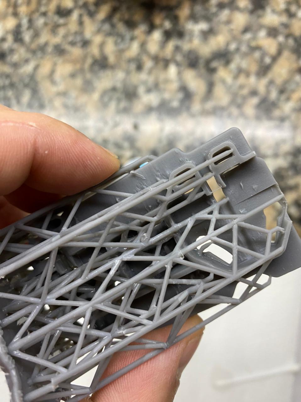

I am having a problem that is causing me to lose a lot of money and work.

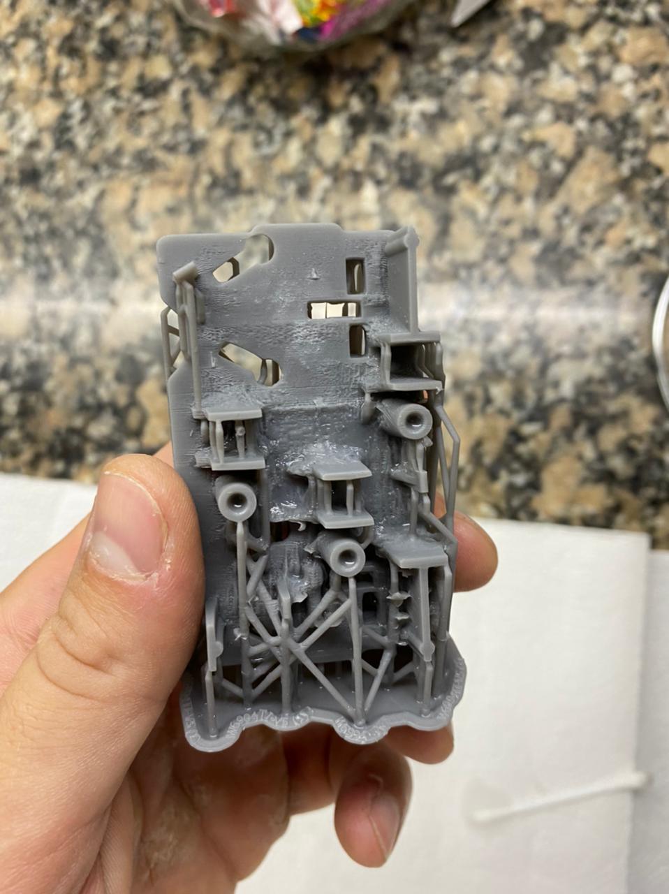

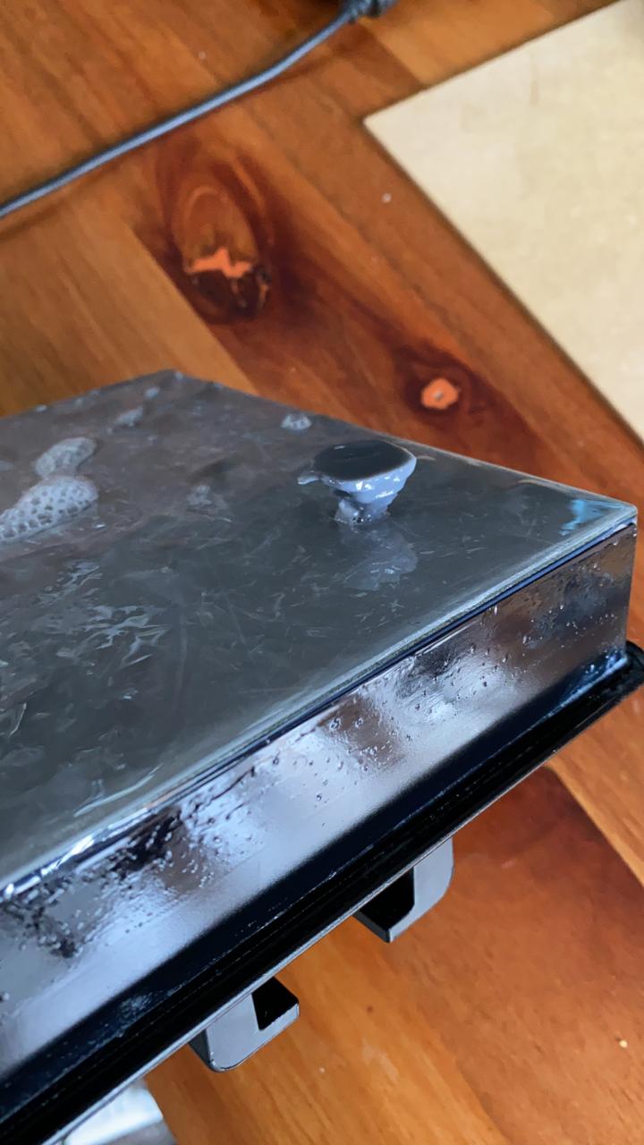

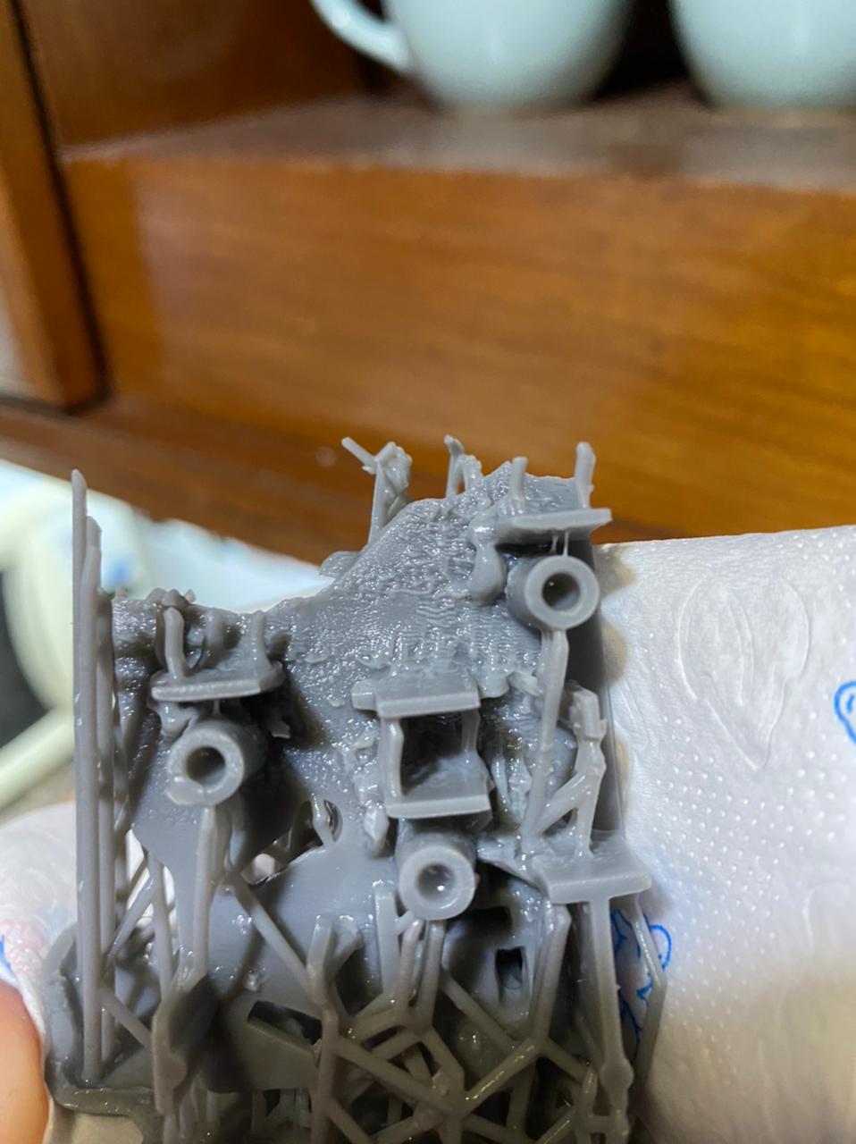

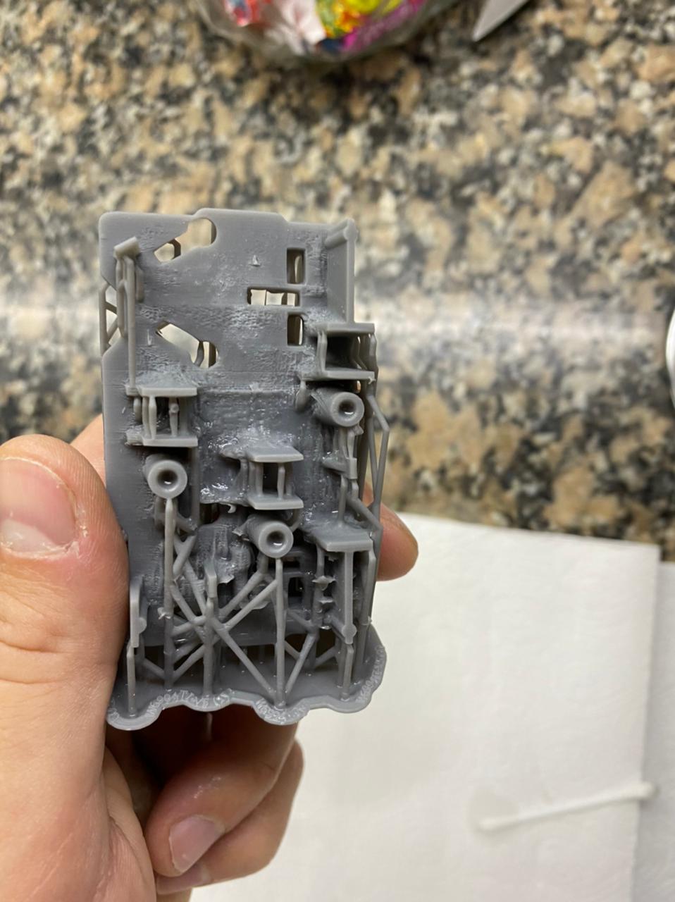

Suddenly and without any changes to the printer, I am having terrible quality in certain places on the surface of the printed part. The surface, as you can see in the photos, seems to have a lot of overcured resin and the supports in certain places are joined together and with the piece, acting as if they were a “Rock”. Also, some holes that should not close because they are big, are closing.
Some photos:
    • I discard that it is the resin, because I tried both with Gray resin and with White V4 resin. I also leaked the resin and it keeps happening
    • I also discard that they are the tanks, since I tested with two different tanks in different sectors of the tank
    • The galvos in the printer are OK, clean and dust-free

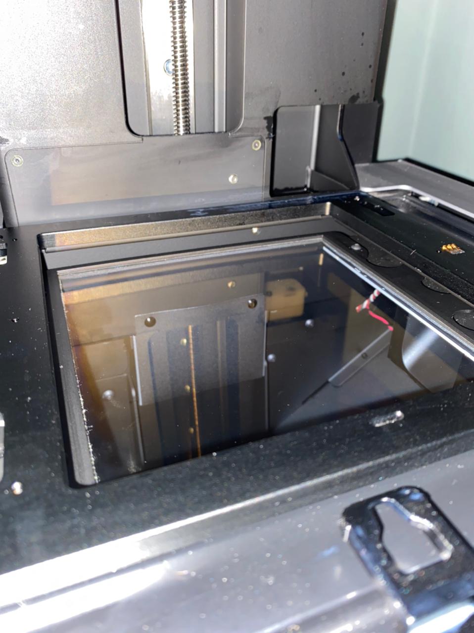

I proceeded to clean the main optical glass, removing it and following the formlabs instructions, but the IPA leaves stains on me no matter how many times I pass it. I was able to remove most of it and leave it as you can see in the photo, although some minor stains are still visible against the light.
The latter caused the problem to continue, but also caused certain pieces to “break” in half. Half remains on the printing surface and the other half remains on the bottom of the tank

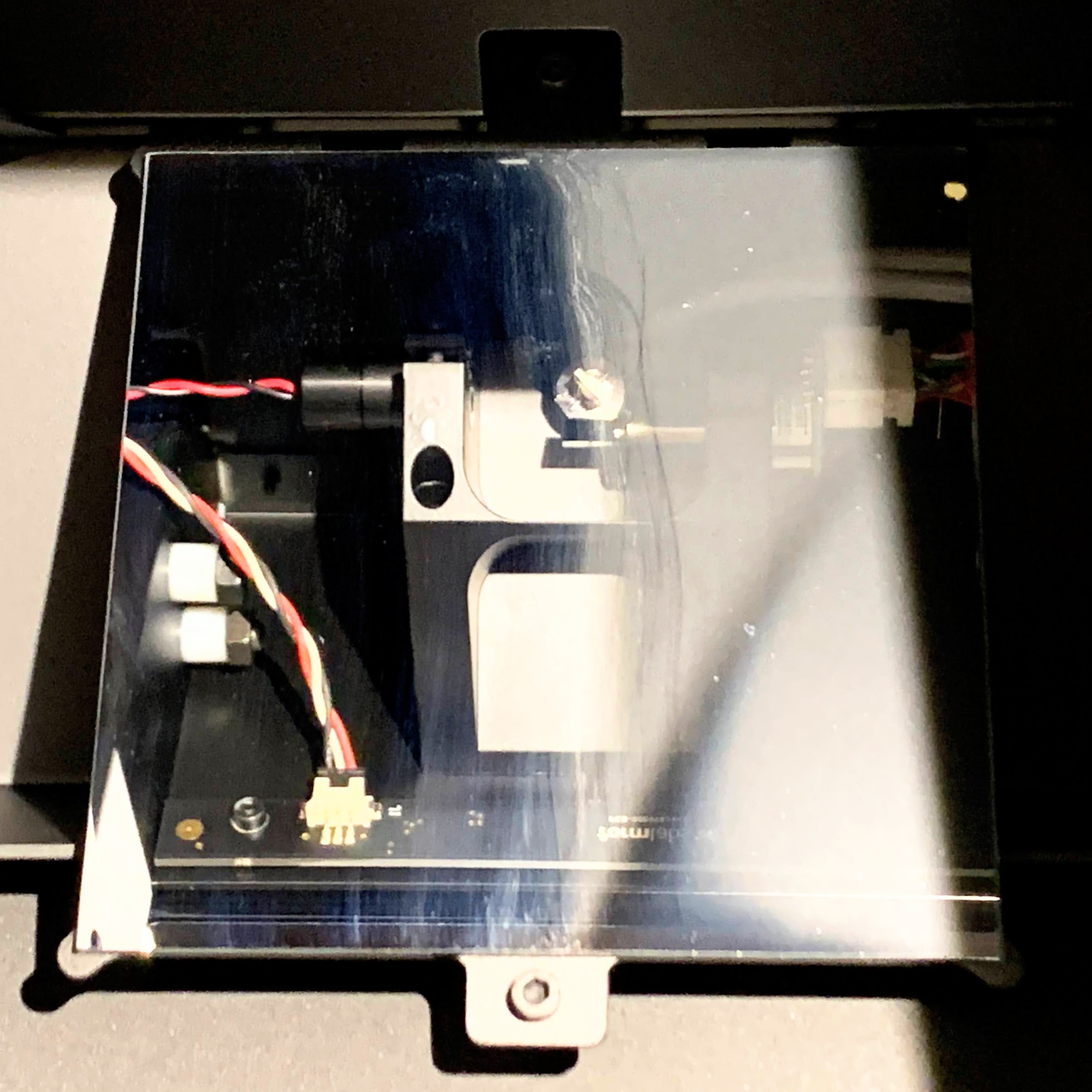

Hey @Joaquinpicci. I definitely feel your pain. A month ago I had the same issue. Just as you I cleaned the main optical window and the galvanometer mirrors. But I did not see you mention cleaning the 3rd mirror. Here is my picture of how dusty the mirror can get. Note that I try to be as clean as possible while operating the machine. But the dust simply piles up after years of operation and you need to maintain it.
how do you clean it? i cleaned everything and still terryble quality
The mirror shown above use a pec pad with a small amount of either alcohol or a lens cleaner. There is an article on the formlabs website that details cleaning the mirrors.
Do a lens cleiner like ZEISS leave less strains that IPA?
I use isopropyl alcohol
You need to use the right materials to clean the mirror. These are “primary” mirrors, the reflective coating is on the front side and it’s just few atoms thickness of Aluminum. Anything that’s even slightly abrasive will mar the mirror and ruin it. FL says to use Pec Pads and that’s the only thing you should use. I have a huge box of Zeiss Wipes that I use for the optics on my laser cutter, but I used Pec Pads exclusively with my Form2 (which I no longer own, upgraded to a 3).
There are also cotton swabs shipped by Formlabs specifically for cleaning the galvo mirrors.
