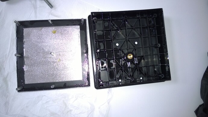

Guys I opened my build platform recently as the screw got stuck. I was surprised to see the inside was saturated with white resin as I wiped everything down before dis-assembly and was about to use it for clear. I would recommend opening it up and giving it a proper clean in IPA before changing resins.
Just to note this is if you are changing resins using the same platform. If using the same resin I never clean the platform after a print, only inspect it for cured bits and never expose it to any light for long periods of time.
