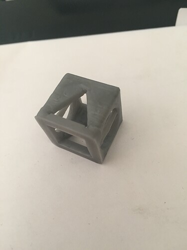

Now i have printed the testcube.
Now how do We go from here?
I have found an old versjon og openFL (2.3.3)
Looking at your test cube, No amount of fussing with a custom profile will help.
Is that print with a new vat, new resin? I think above you said it was.
You are still getting good results with FL resin, right?
I would send Photocentric a note and ask them.
If the model looked clean but was oversized or undersized, we could work with that.
There shouldn’t be too much different between the Form 1 and Form 2 resin profiles (not that we know for sure). Only slight differences due to the different lasers and galvos. The results off both machines should be very similar with the 2 printing the better looking more dimensionally accurate models.
The rook looked like it came out much better then the cube. That is why I was thinking we could build a custom profile to get your results closer to FL resin prints.
I would verify that you are still getting great prints with the FL resin and as long as you are, reach out to Photocentric and see what they say.
Yea its a new VAT and a new buildplatform.
I have printet just 4 prints with FL resin clear2 and they have come out perfectly, the only mistakes there are the ones i made.
The FDM printed rook is about 3mm shortet than the SLA printed one but that is just the base of the rook being thicker on the SLA.
guess an Email to photecentric3d is the next thing too do.
just hope its a bad batch then, only problem is i ordered 5 liters ![]()

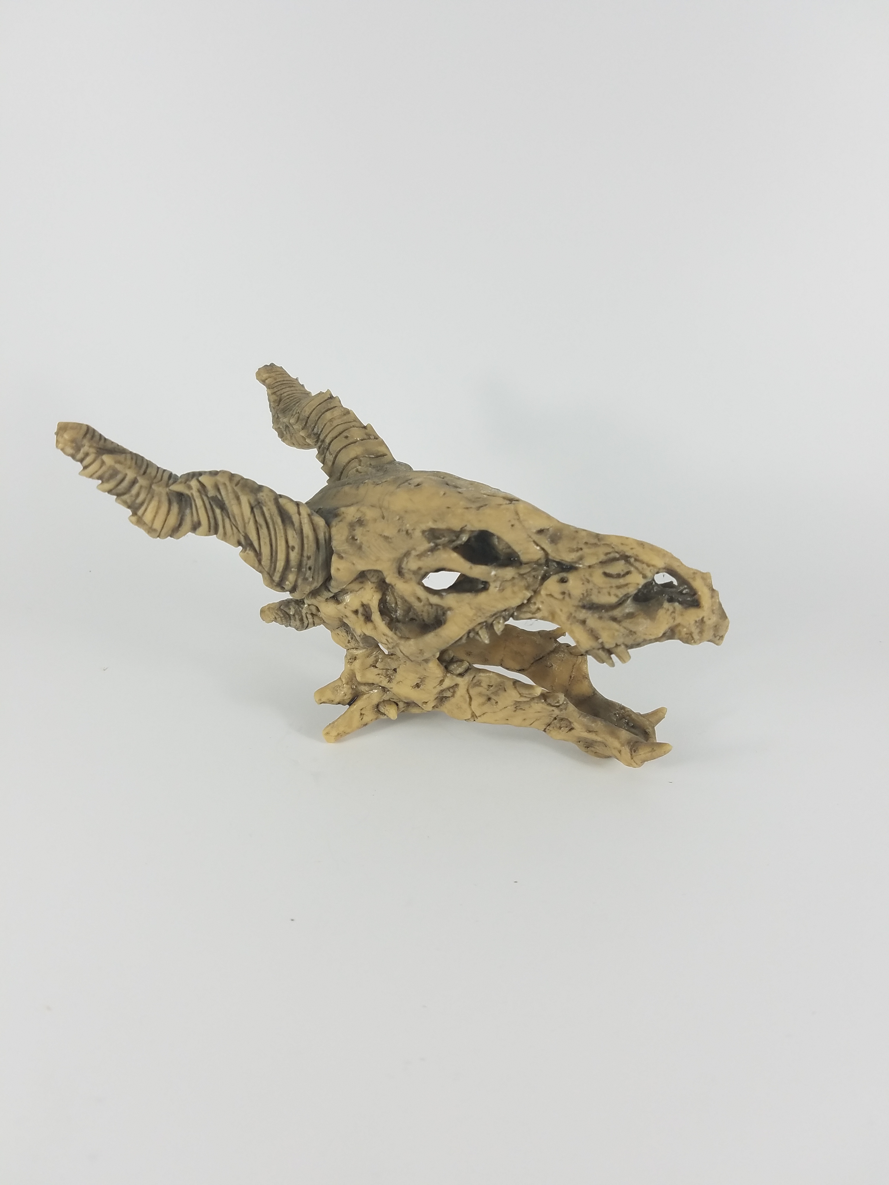

Just thought I’d update about this! I have been trying their resins for about a month now and have had little issue with it (other than occasional support failure when I try to use .3 point size).
My nicest print has to be on their Hard resin (I got some of the beige). The skull is about 2" long (3.5" with the horns) and around 1.5" tall at the highest pint (2.5 or so including the horns). The bottom two images are the print after I sanded and weathered it using enamel.

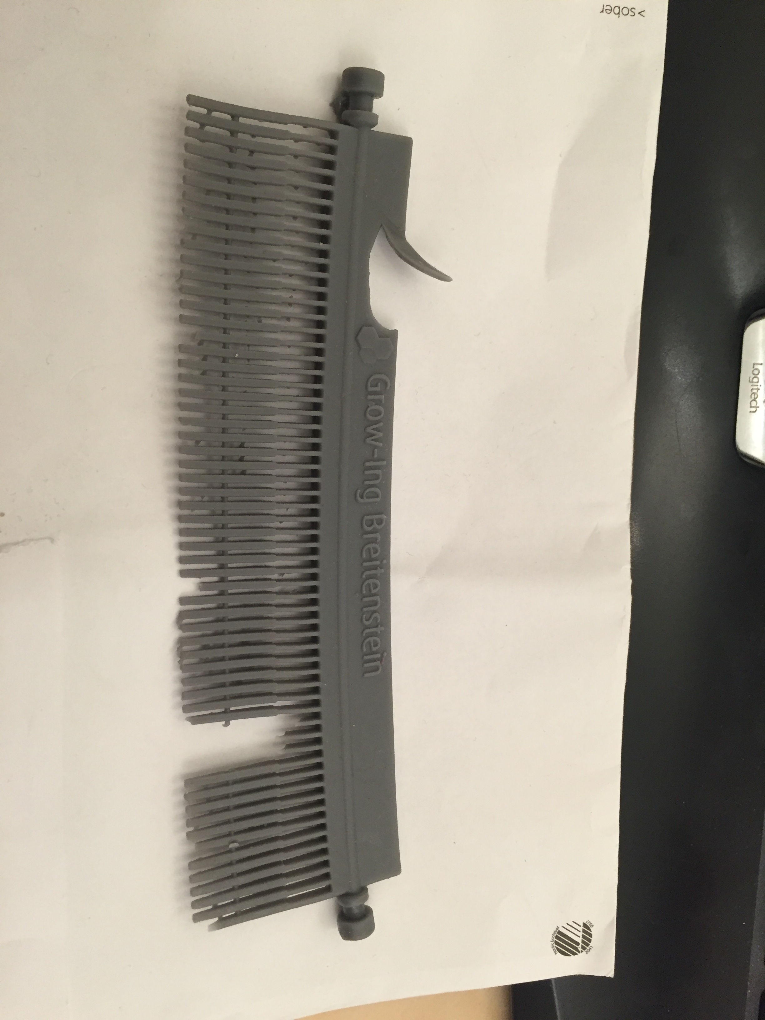

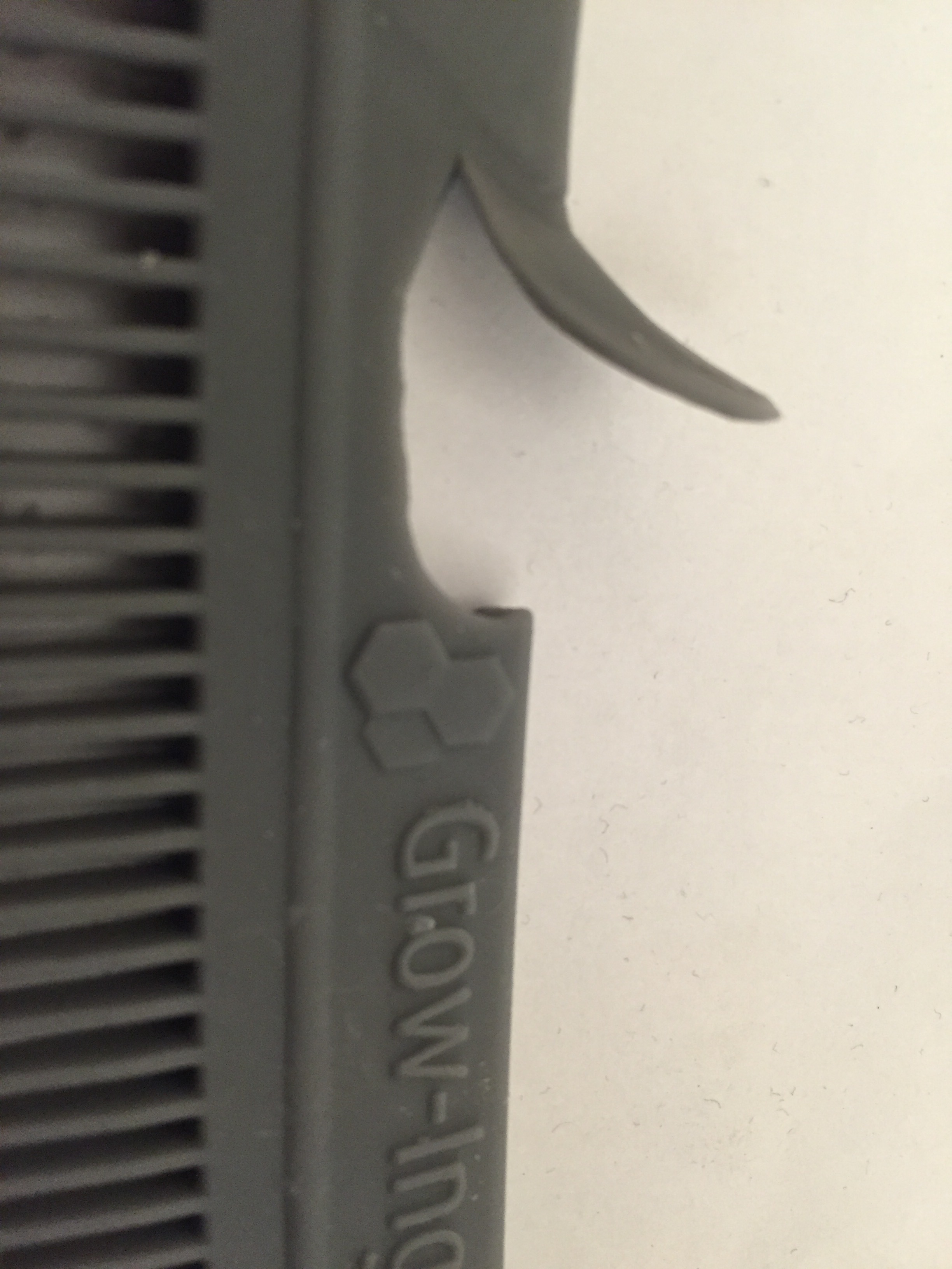

@Teamanimal, I’ve printed this comb Comb designed for cleaning the resin tank and it printed well. The model has some lettering and a logo with low height extrusions and small gaps (crevices) which were successfully printed, there was some warping on the top edge but I think it’s lack of supports. See the picture below:
I take it this is on your custon grey settings?
I will try something later today then.
now i am really excited
Really good print. What printer do you use? Look like as DLP printing. And what size of this model?
WOW its all i have to ad.
one defect but who cares with this level of detail.
I was a little brutal with removing the supports so i broke some of the combs but it was still just a test.
@Silvio_Augusto - I would say you grey settings are just spot on
A little brutal? That’s not usable now
