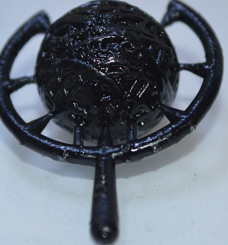

hi, i print jewelry model for a silicon mold but i’ve a lot of problems about the definition of the object.
the top of the print it’s perfect but the part below it’s horrible, i can’t made a mold with this.
i print print with 25 micron of definition because i must have a perfect details.
I would like to know the cause of this mistakes,i must put more support or i must change my print method?
i post a photo for you,the second photo it’s the right part.
thank you for your answer

Maria, there could be several reasons for the surface finish you are seeing here. I would recommend that you contact our support team so they can help figure out whats causing this.

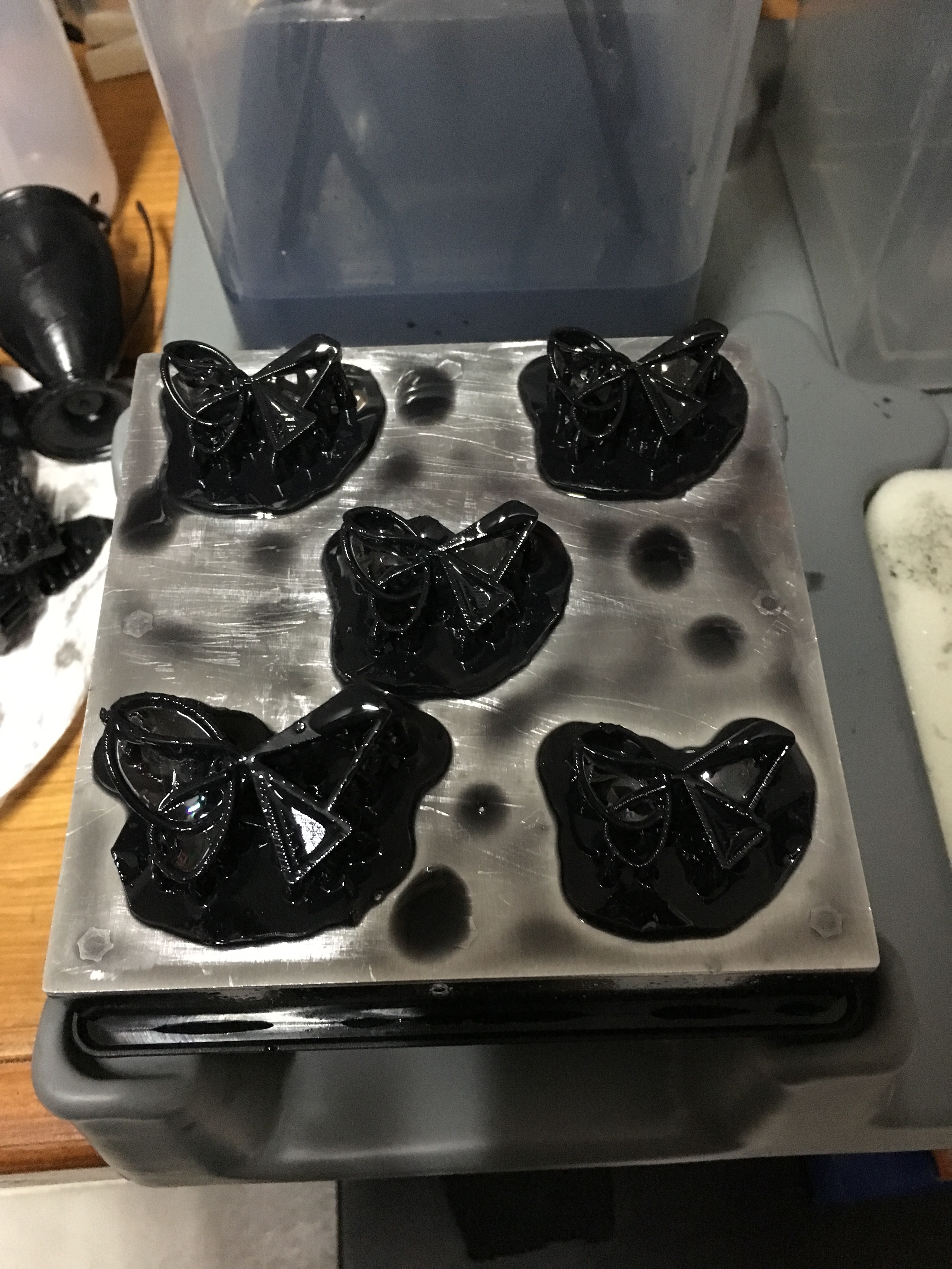

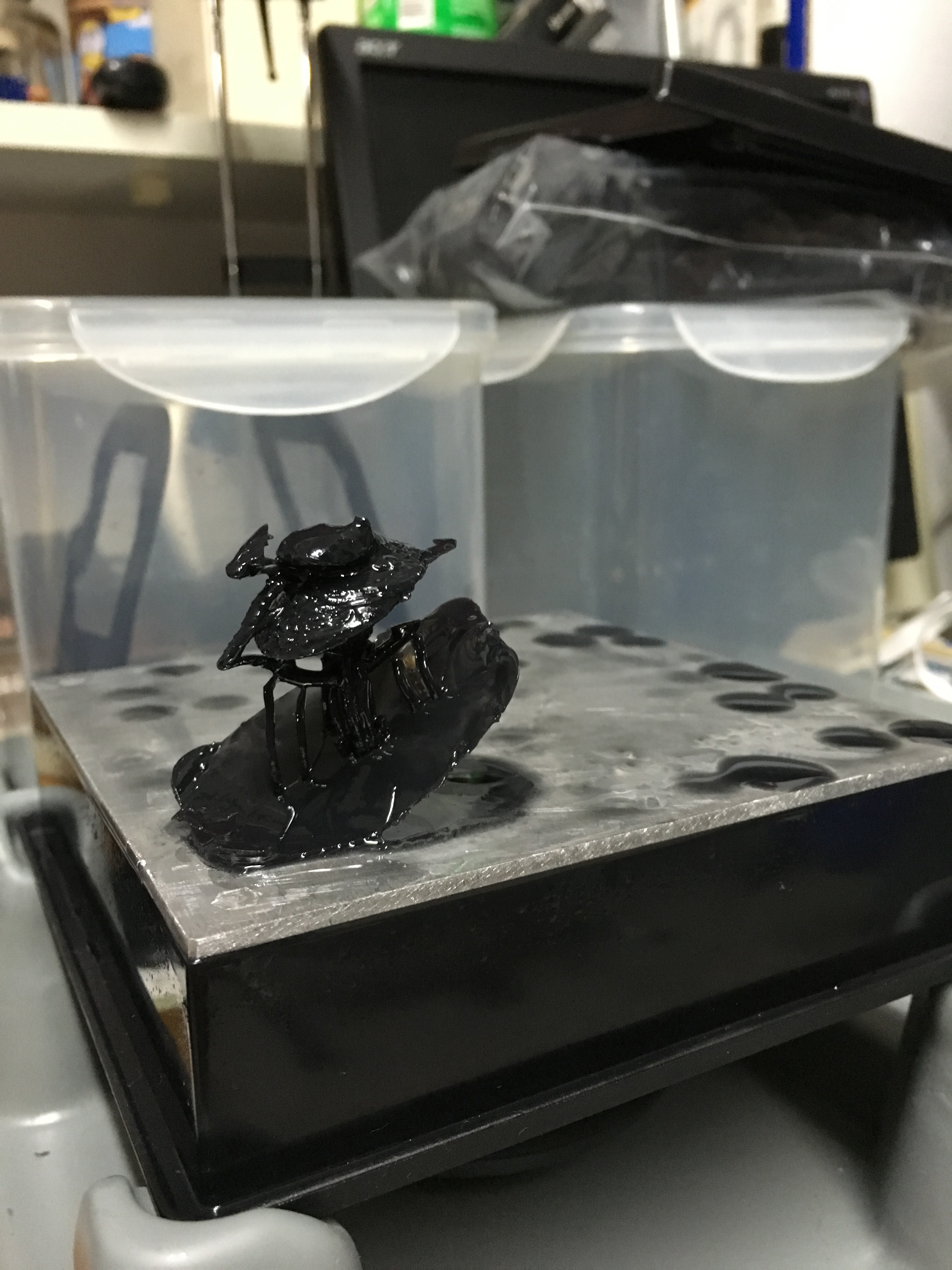

I am running some test prints at the moment after cleaning the tray, the resin and put in new supports, so will let you know what we found the problem to be,

Maria, I did not see a ticket from you in our system. Have you been in contact with our support team? You can also try inspecting your mirror for dust, which can sometimes effect print quality. We have a walk through of inspection here:

We did a test print with a bigger base and sturdier supports (after cleaning the resin) and it came out very well, so it may be that there is too much movement on your piece as it is growing. That was definitely the case with my client. Hope this helps

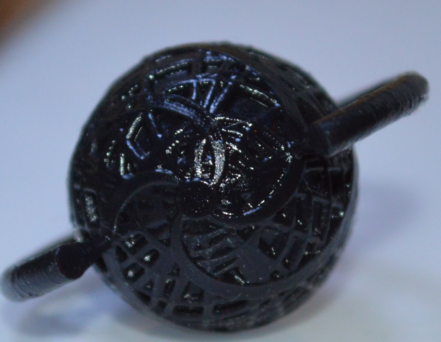

hi,
i clean the mirror before the print of the first photo…
my last print it’s this…
it’s the same model of the first photos, it’s not a modern sculpture …
