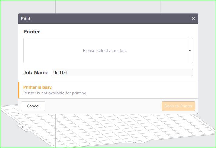

Here is the error below that I am getting. The printer (when I go to it) shows that I have what looks like at least 10-15% left, but I am not sure how to get an accurate numerical reading from the printer? There is also plenty of resin in the tray.

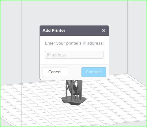

There are no printers seen in preform and I try to add a printer and it asks for the IP address.
