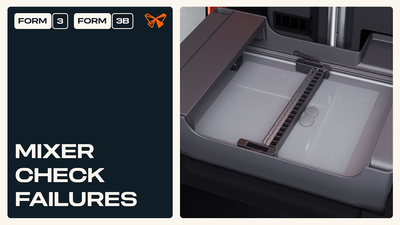

Hi! I just wanted to pass along our youtube video explaining how to work through some common Mixer Check Failure troubleshooting steps in case it helps anyone experiencing this issue!
Please consider subscribing to the Formlabs Support Youtube channel so you can see our weekly uploads!
