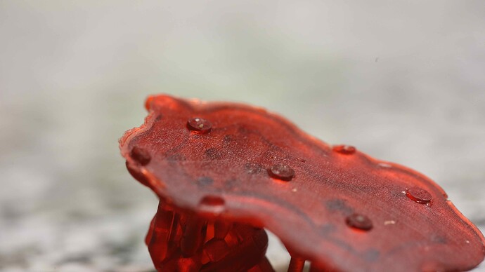

The largest cause of failures for me has been builds falling off the plate. The holes really help prints stick to the plate - much better. It adds more surface area in contact, and greatly helps prevents slipping.
I also lined the holes up with the grid in PreForm, so even for small prints I know it will land on a hole.

Not sure how the hole would help because you will lose surface area for the parts to stick to. Best bet if your parts are falling off is to make sure the platform is a little scuffed up.
If you still have problems then it is possible you need to fine tune the platform so you have more pressure. It might be off just a little and enough so you your not getting good first few layers to adhere.
What resin is that? Doesn’t look like Formlabs. If it is a 3rd party resin then it might be slightly under exposed which would cause it not to adhere to the build platform. On the other hand that extends your tanks life.
Even filling the holes a little bit like that I think is still less surface area than without the holes. But it probably helps to have the grips since it has a sliding force to separate each layer from the tray during printing.
Actually they have slightly more surface area in contact. They fill about 0.6mm deep, and with a circumference of 2.29mm, that means they have about about 4.31 square mm in contact. Compared to the area of 4.15 square mm for the same circumference of the build platform.
To double the surface area where the cleats are, I should drill the holes only about 0.5mm deep. That way it would get full plate contact plus the additional area from the sides.
