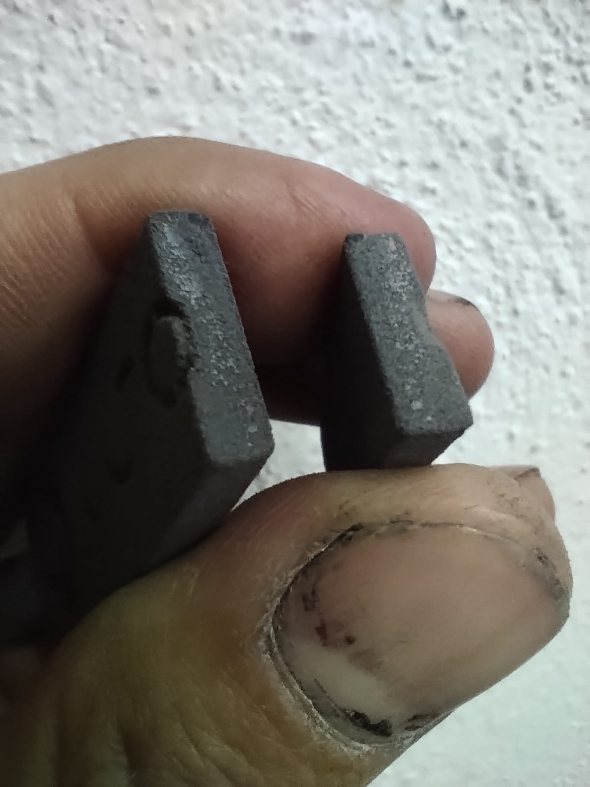

After unpacking both failed builds I noticed that the second one has brittle parts randomly appearing.

When the material cracks up like that in your latest issue, for us that has been caused by temp issues.
I had an issue on our Fuse 1+ that the heat leaked up into the hopper cause when i started a new print the first layers looked like that and when i tried again it worked.

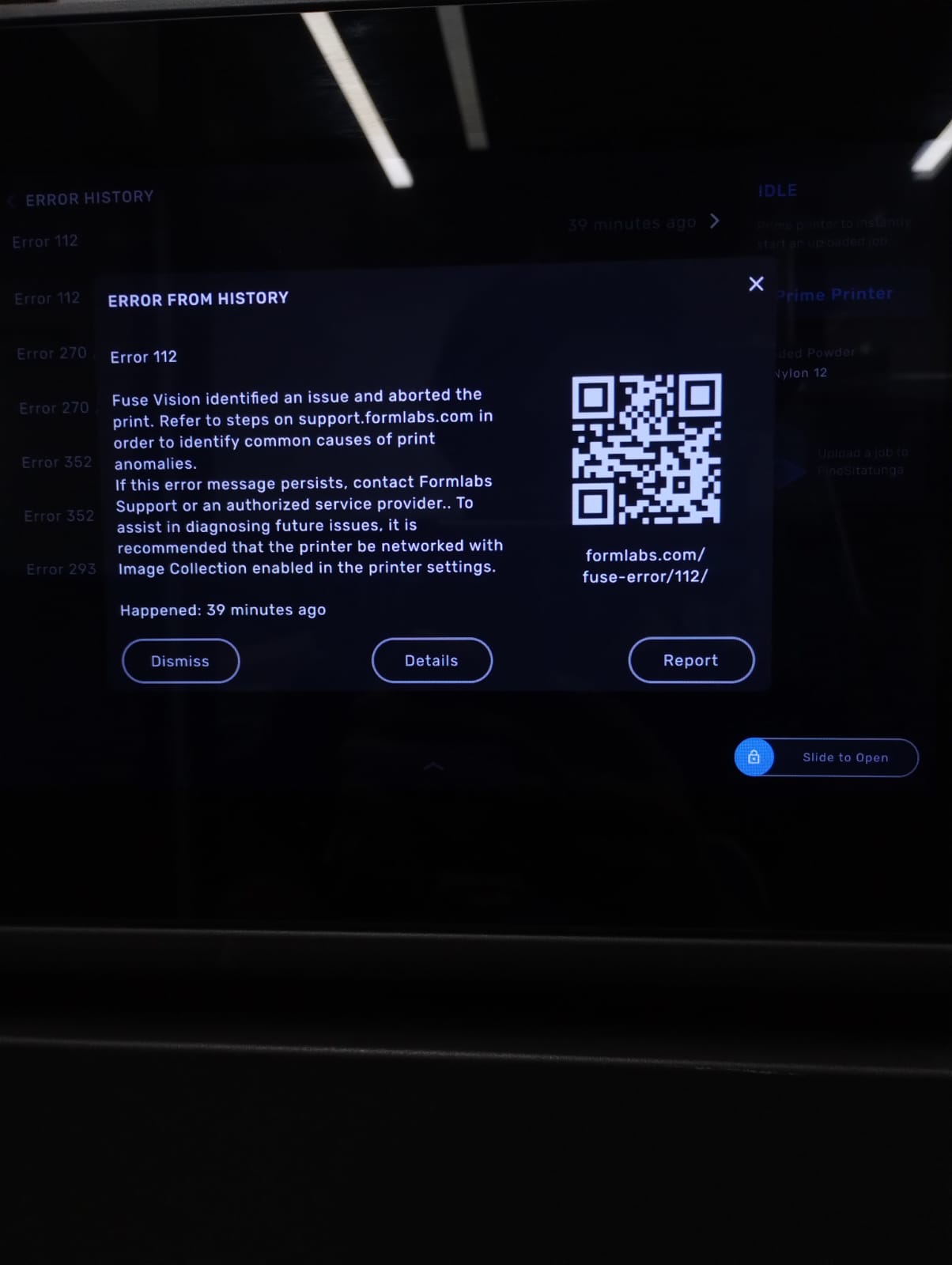

we are not using third party materials all is Formlabs powder. Today we wake up with yet another problem also not related to software or firmware. And the funniest thing is that due to this problems with our machine, our service provider stepped up to help us with production(using the latest software and firmware versions) and guess what ? Their machine failed also with a very weird issue.
this is the error on our Service provider machine, while processing one of our jobs, coincidence? I don’t think so.
That’s really odd, I’ve never seen anything like this with my machines. Since you are working with support you should obviously stick with their recommendations. Id be thinking of what’s common between your machine and your supplier.
The only common thing is that both are Fuse 1 machines, not Fuse 1+ 30w and that they are located at less than 10km each other. We already solved it, but not thanks to support.
This is really weird errors you are getting. Glad to hear they have been solved. How did you solve it?
We rolled back to the nov firmware and dec preform. Made some checks on our UPS and power delivery and turns out there were some issues due to increasing demand in the grid. Probaly if support would’ve taken the time to review our logs we could’ve narrowed it faster but hey didn’t, and he fact weird errors appear on a different machine running the latest versions doesn’t help thrusting it will solve the problems.
