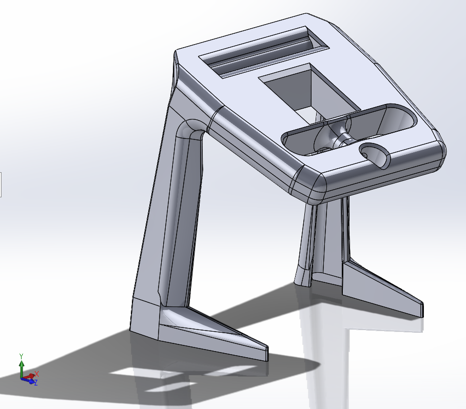

I don’t know about anyone else but if I leave a tool on a work bench unwatched for 30 seconds someone will have already pilfered it for another “urgent” job. So I’ve created a fairly natty little tool rack to fit all of the tools that ship with the Form2.
I’ll be printing it tomorrow as we have a fairly considerable print queue building up today and will post the results here so you can see how it came out but for now I’ve posted some screenshots below showing the rack
As soon as I have some pictures of the finished product I’ll post them here and if the model comes out okay then I’ll upload that if anyone else wants a tool rack for their Form2.

What a practical and useful design. Please do share when it is all perfected.
Looks great! I’d very much like to have one too.
Would there be room for the needle nose pincers as well?
The opening at the front is built to accommodate the tweezers, this feature was a lot easier to model so I didn’t end up modelling out a rough shape for the tweezers. Once I’ve fired off a print and know it all prints without issue I’ll upload the file.
It should fit all of the tools that come with it, I was going to put a small stuff box for a pair of rubber gloves aswell on the side but couldn’t find a tidy way of fitting it in but apart from that I think it fits pretty much everything you get with the form 2.

That’s a nice design. The only thing that I would like to see is a integrated drip pan with large radii at any corners. I only mention this because as hard as I try to keep stuff clean, I usually miss something. An integrated drip tray would help keep area clean.

Okay so I’ve finally got some space on the printer, I’ve added a removable drip tray that locks into the feet of the stand so you could slide it all together if you wanted to, it’s drips also sloping towards the front so any drips should migrate towards the front where you can wipe them away.
In about 7hrs 45 minutes I’ll let you all know if it was a success and I’ll upload the files.
