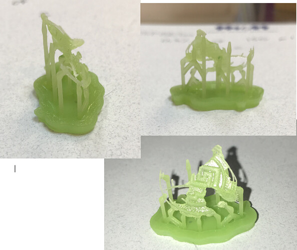

Reporting details on 3DResyns UHF color base, with added custom pigment from them (RAL #6018):
- Started with 150 ml of UHF color base, uncolored (coloring paste comes in separate vial)
- Added 0.45 ml (approx) of FT1
- Added 5 drops of coloring paste
- Mixed thoroughly and printed in Open Mode with Grey V3 profile
Result: Fail
Notes: Raft adhered no problem, supports look normal.
Maybe the coin I am trying to print is too thin (I shrunk it down pretty far for a quick print)?
I would measure the thickness of the thin part of the coin that actually printed. It does look pretty thin.
I print coins completely vertical and along/parallel to the front. Less supports and seems to work well.
Per 3D Resyns included documentation:
Added 0.1% more FT1 (I actually made a mistake here, I had calculated 0.1% of the total resin (500 mL, instead of my test batch which was only 150 mL. So basically a put in 3.5x as much as they recommended, on accident)
Mixed thoroughly, printed and cured:
Result: Success with bleeding (excess depth of cure, because I accidentally added too much FT1 which made it over-react, I’m guessing)
I had to add LB1 to all of the resins to make them print properly. The laser in the Form2 is pretty strong and tends to cure deep regardless of adding pigment. Pigment does help.
LB1 is your friend with cure depth issues. Once you get it right you will be able to see layer lines on the back side similar to the front. Shake LB1 well and I would start at 1% with resin that has pigment. 1.5% for clear. You can always add more…
