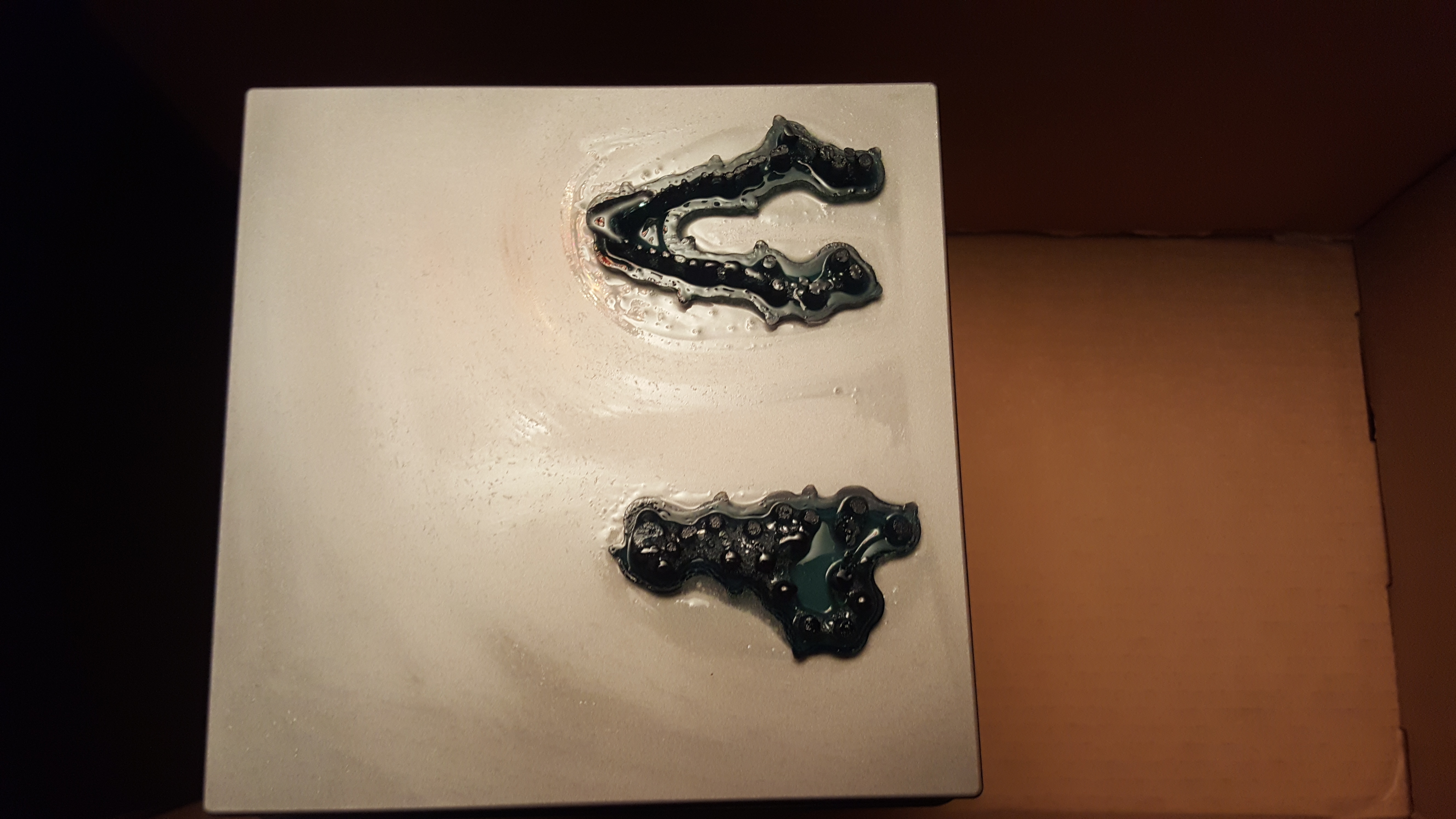

Plenty of experience with the form 1+, finally got a form 2 and it appears the wiper detached while printing something I’ve succeeded with on many occasions. Is this common or an absolute freak event?
Every single support that was forming was stopped in an instant and a nice island of goo in my new resin tank, brand new tough resin (1.0)
The wiper was found at a bit of an angle, within the path of the build platform detached.
Added some images- see how the print just stopped like it was cancelled?? I wish.
I’ve never seen a properly-inserted wiper come loose. I have occasionally had trouble getting the wiper to snap into place. Perhaps that’s what happened?
It seemed to pop into place correctly. I didn’t expect it to move quite so fast when in use, I can see why they limit the wiper from open mode.
Anyhow I caught it fast, cleaned out my resin and had success with the second try at the job. I’ll blame me this time.
