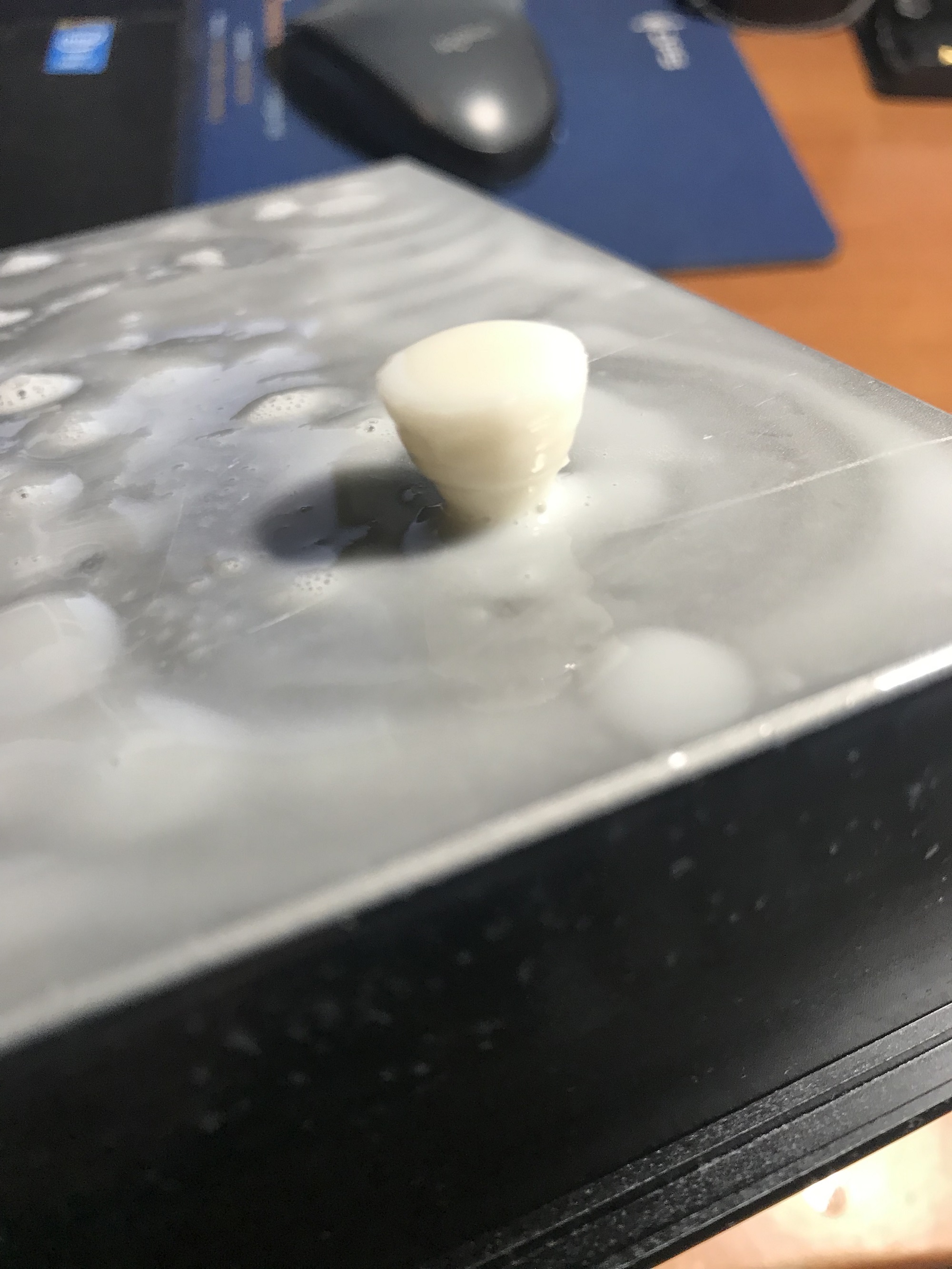

I have big issue with my printer. Last 5 prints look same like on the picture. Anyone had that kind of problems?
Resin are new, tank quality is ok. Cleaned glass, mirror and galvo mirrors. Printer is around 2 yeras old.
Thanks in advanced for halp.

It does look like an issue with dirty mirrors or the laser itself
It does look like that to me too, but he said he cleaned it.
Tomoo, could you try doing an optics test? See how that comes out.
In my opinion this test will look same like others prints.
It looks like laser dot spot is bigger than it should be.
Or maybe something is wrong with data…? Can I slice and print part in older preform version?

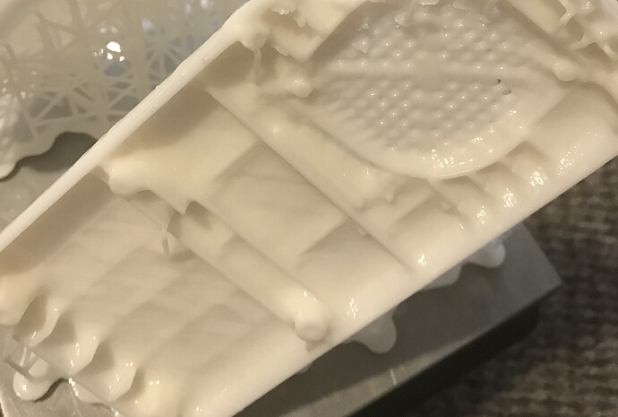

Other print:

Yep, its looks like a dirty mirror.
Have you experianced cleaning the mirrors before?
If so, clean both sides of the 2 Galvo mirrors, the large mirror and the glass below the tank from the bottom and the upper side. It is easyer to clean the glass bottom before cleaning the large mirror as particles will fall on that mirror.
After cleaning run another optic test and please share the results with us.

Cleaned everything before optick test print. Glass on both sides, mirror and galvo mirrors.
Thing is that the last good print was in much worse conditions. After first bad print i checked glas and mirror and they ware very dirty. Its not a cleaning problem.
