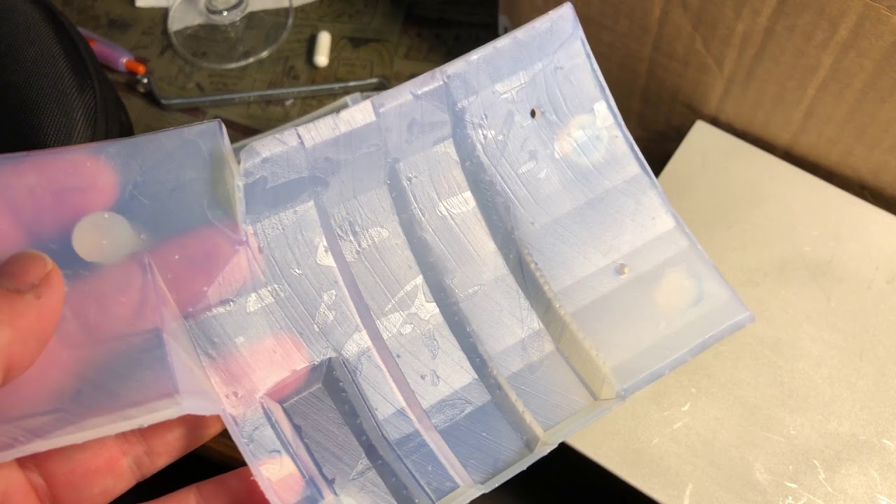

What kind of artifacts? Did they look anything like this:
And no, these aren’t hardened resin that wasn’t washed properly. These prints haven’t seen the light of day yet, much less UV curing. They were like that straight from the Wash. In fact, when i rinsed them with the IPA bottle before putting them in the Wash, they were already exhibiting markings/mottling like that.
I thought it might be the fogging on my tank, but that makes no sense - they’re way too sharp edged.

No, not like that. Unfortunately, I didn’t keep those. It looked more like strands were hanging off different parts of the print with rough surface underneath.
Didn’t experience that.
But i’ve just realized the artefacts are due to odd changes in refractivity in the vat.
They’re visible as same splotches, but only when lit from an angle, and they have super-sharp boundaries.
Contacting support, as it’s obviously not related to PreForm (just noting here for posterity).
