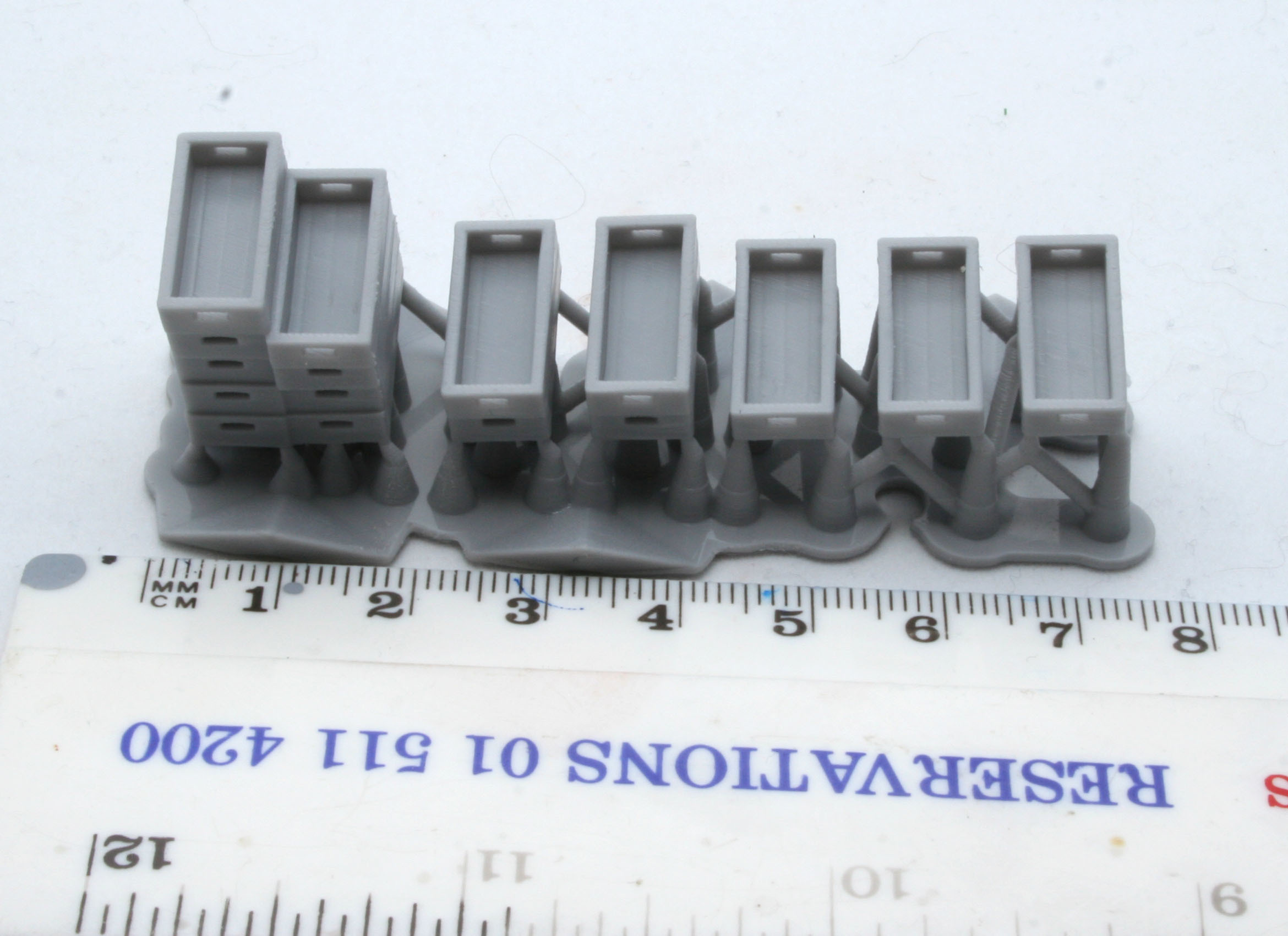

Hi ashtree,
The FunToDo F1+ series have been developed especially for the Form1 and the Form1+, not with the Form2 in mind.
The software settings are the same as the Formlabs. So Grey V01 for the F1+ Grey, Clear for the F1+ Clear.
Although we haven’t tested it on a Form2 and we therefore can’t recommend it, there are users who have tried working the F1+ Grey on their Form2 and are pleased with the results, especially the resolution. (see other threat)
