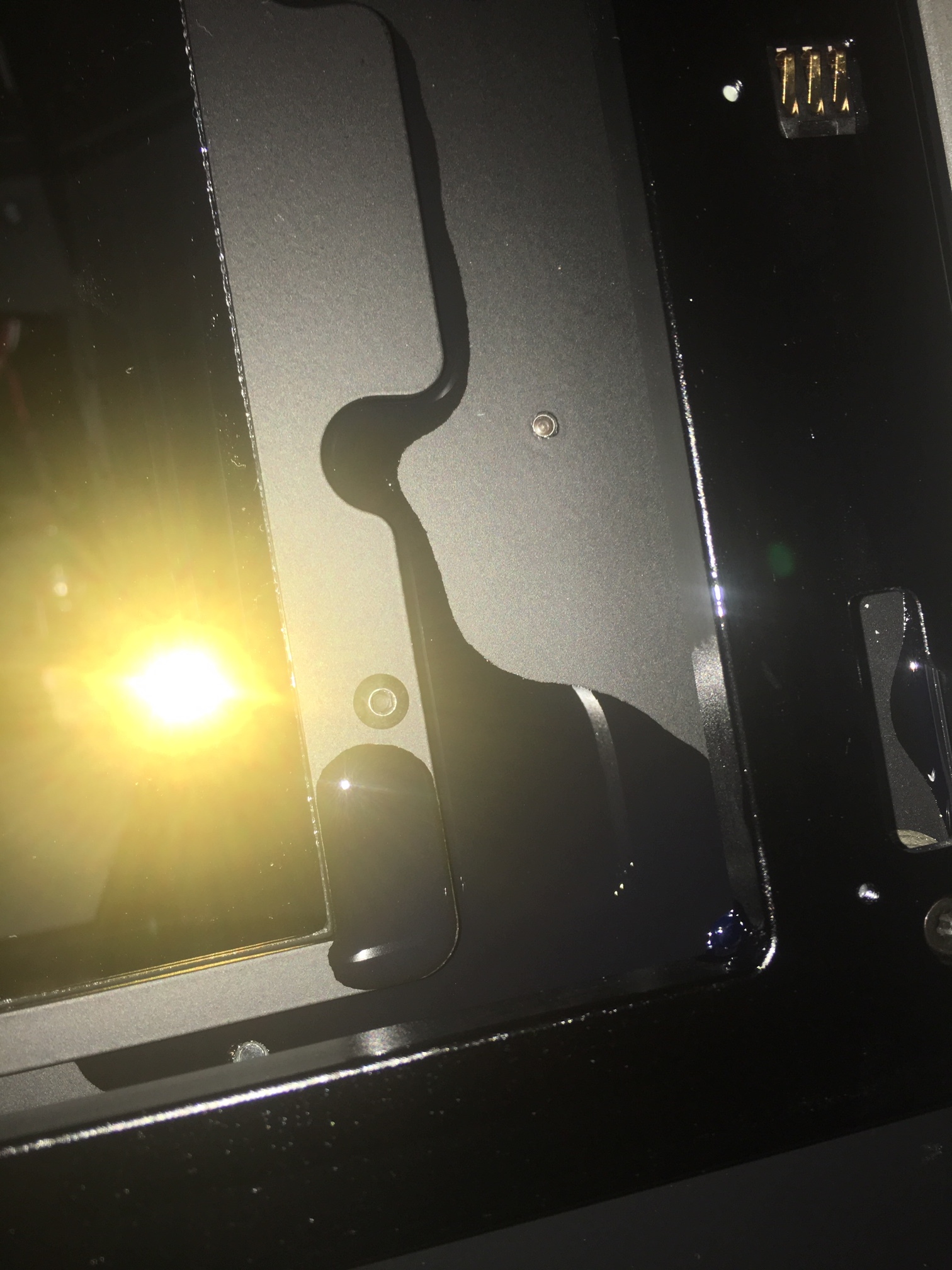

I just discovered a spill, I see it leaked under the first metal tray, any tips?
Open a ticket with Formlabs they’ll quickly send you detailed instructions for disassembly and cleaning.
