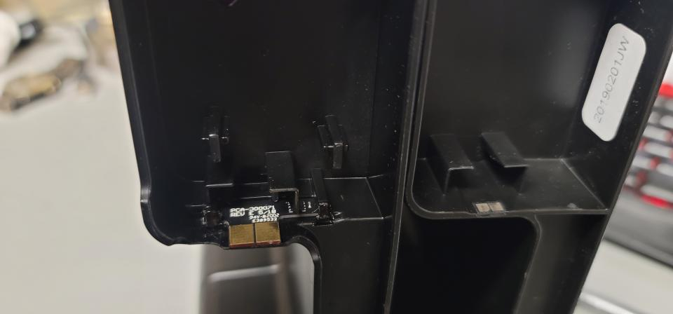

After pulling part the back to clean the prong fingers of the sensor, I noticed the frame where the resin tank sits gives and flexes down when there is a cartridge is place in the printer.
So I decided to see what happens when I stabilized it. To my surprise it worked. The printer was detecting the castable resin cartridge.
Now that’s great. But why is the durable resin cartridge not being detected?
After comparing the two cartridge sensor plates I think I know why.
The left cartridge is the castable resin which the printer is now picking up. The right is the durable resin which the printer is still not detecting.
Hopefully this helps some people out.

I fixed the missing cartridge problem doing this:
This worked for me too. I owe you a beer.
That solution worked for me too. Thanks so much @crwalters
