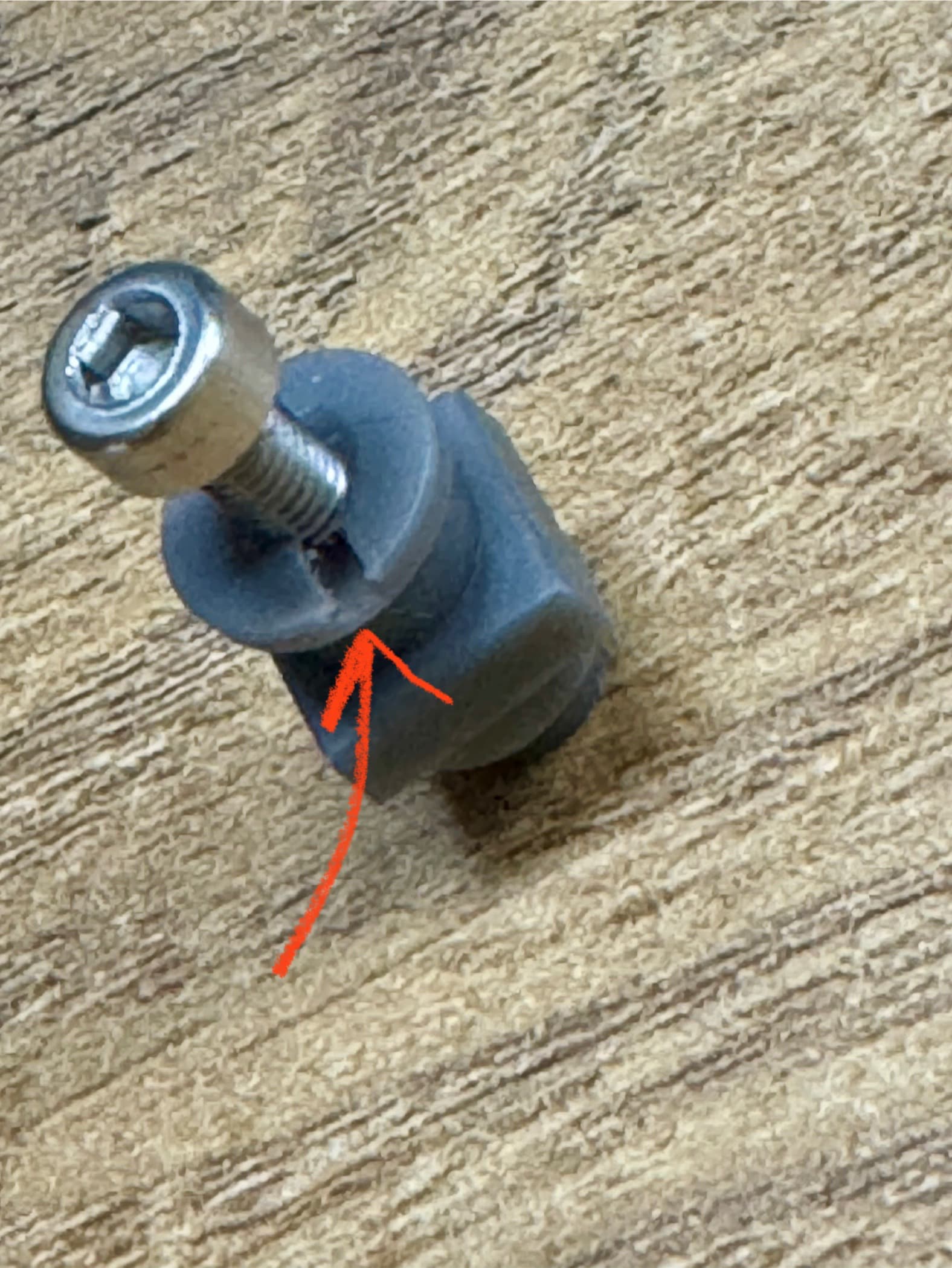

I have attached some pictures of the print a did for a client. The part in BLUE is FDM print done on my Ultimaker printer (due to cost constraints). The grey part was printer with Standard V5 resin and the Early layer adhesion settings were adjust to reduce the “elephant’s foot” effect. The plus side of printing this way is ut uses A LOT less materials for support. The arrow indicates the side that was printed on the build platform.
These were printed vertically on the build platform so I can get ±10 in one print. So here is where it does shine
 It took me 3 days to print, wash and cure the SLA parts for entire order on Formlabs, and 5 weeks to do the FDM parts. Also if you are using M3 or bigger screws, you will be able to print threads that actually work ok, not need for inserts.
If you do decide to pull the trigger and buy a Form4, buy the flexible build platform for sure. It will make your life a whole lot easier. Here they are simply too expensive, so I am using a scraper with a VERY thin blade to remove parts (not the one that comes with the printer, it will damages the corners).
