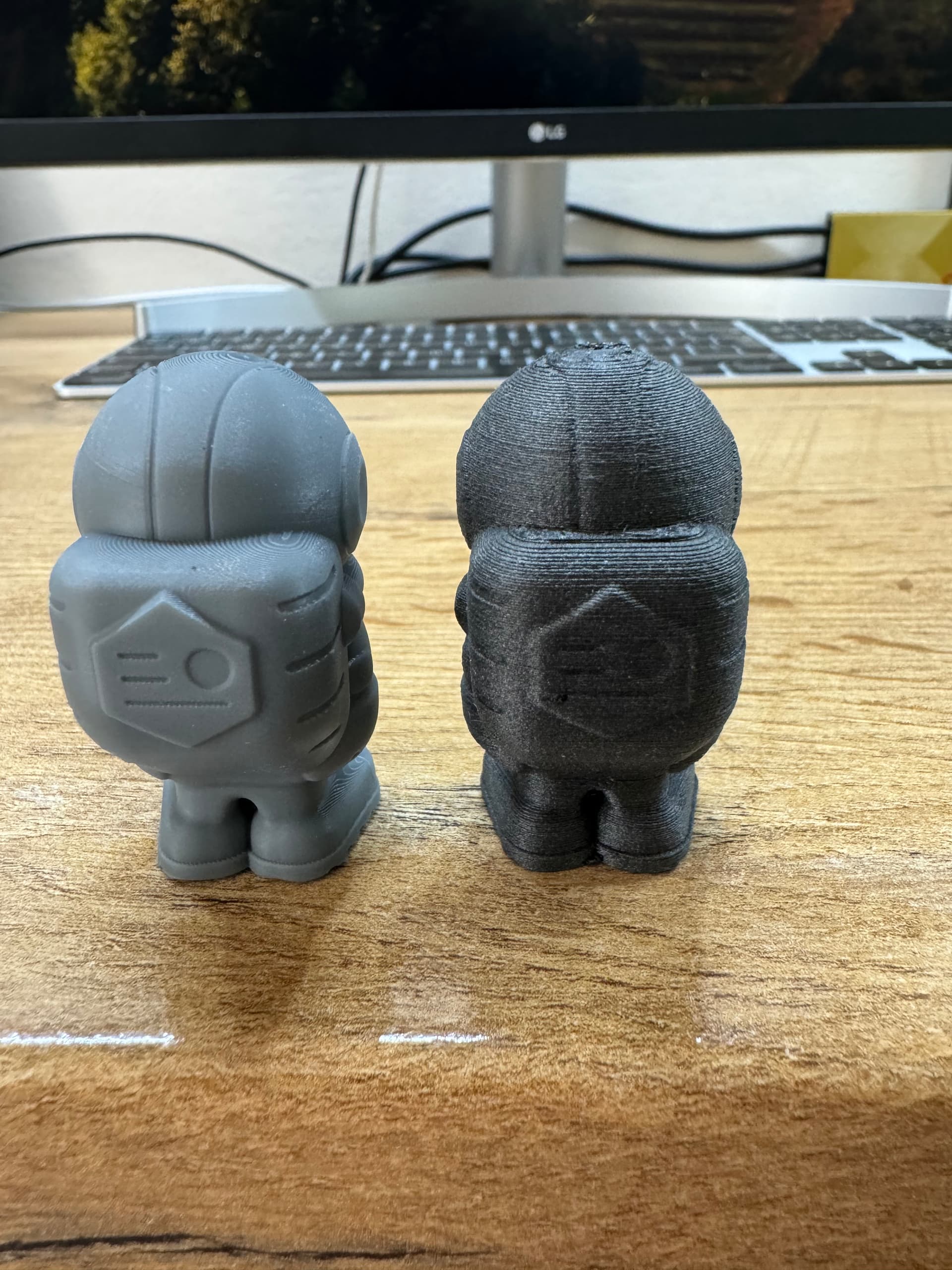

don’t get me wrong, I can print really nice @matterhackers Astronaut Phil figurines… but this is not why I bought it. I need to print enclosures.
I will try to increase the wall thickness of those small enclosures to 2.5mm as apposed to 1.5mm but cannot see that it would help much. I would like to try and and print it in the precision model resin @eaglechen suggested but I do not feel like spending more money on testing. I am sitting on couple of liters of V5 resin and have used 4 tanks for the different colors.
Below are two prints… one done with Fillamentum Nylon Carbon fibre using 0.6mm ruby print core and 0.2mm layer height. The great is Formlabs V5 resin at 100µ
so yea, really nice figurines…

Making the walls thicker should not affect issues that you are having with the optical quality. I can see a moire effect on the top of the model mostly on the feet, the backpack, and the head. I’m not sure if this is due to the 100um layer height or more of a side effect from the screen/optics used in the Form 4. Either way, it’s not like the laser variants in terms of quality.
