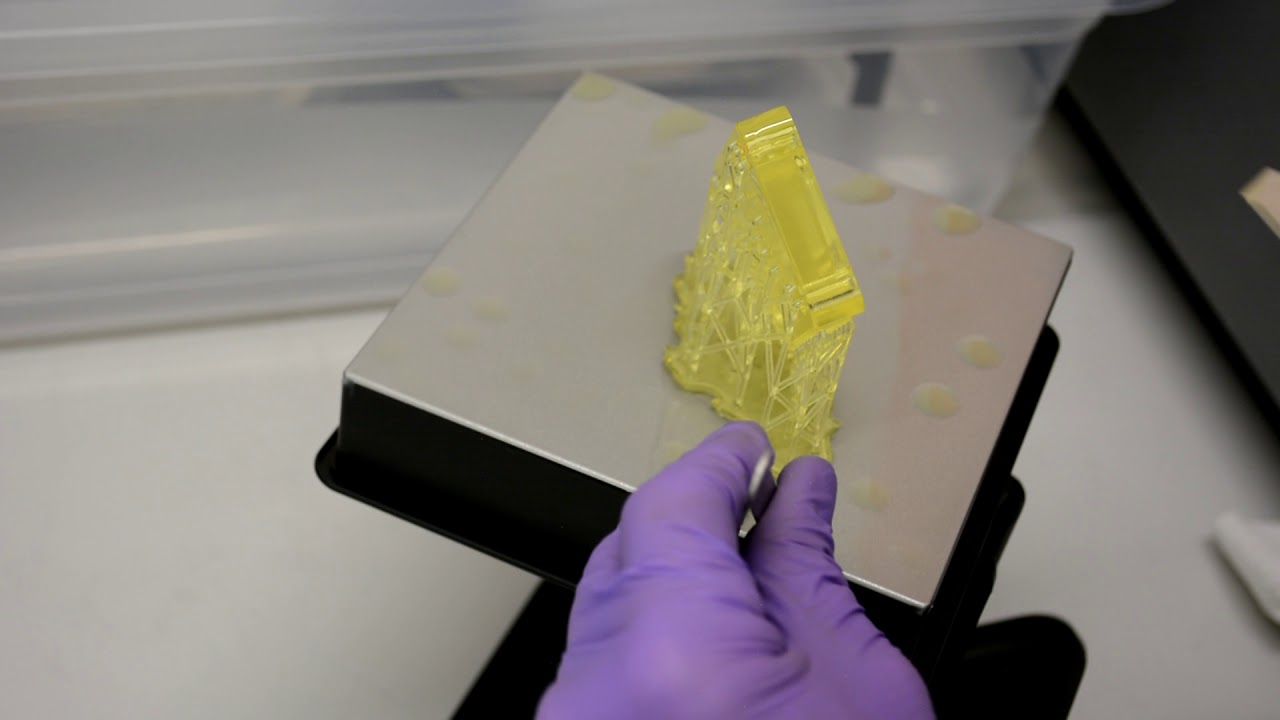

Every time I’ve used the removal tool, I’ve scratched the build platform, which can produce aluminum particles. If the platform is not cleaned this particles can be found later in the resin tank.
Cleaning the build platform costs material which many users dispose uncured.
grafik
However I like the removal tool, it works ergonomically good so I’ve developed a cover for it.
grafik
It’s cnc-machined of PEEK, a very durable and stable thermoplastic, which can’t scratch the platform. The tip is sharper than the original for easier sliding under printed parts. The cover is 3mm high, just 0.4mm higher than the original scrapper.
The tips are interchangeable to ensure bio-compatibility. That was important to me since I’m working with standard and dental resins on the same machine.
I don’t wipe or clean the build platform, I just remove the part and print the next one, saves material.

This is a great idea and I’m impressed by how new your build platform looks. Mine are usually pretty weathered after a few uses. How many uses are you getting out of each cover?
Thanks :slight_smile:
I’m still using the first cover since 3 monthes without changes in performance. I’m printing several times on a day Monday - Friday.
