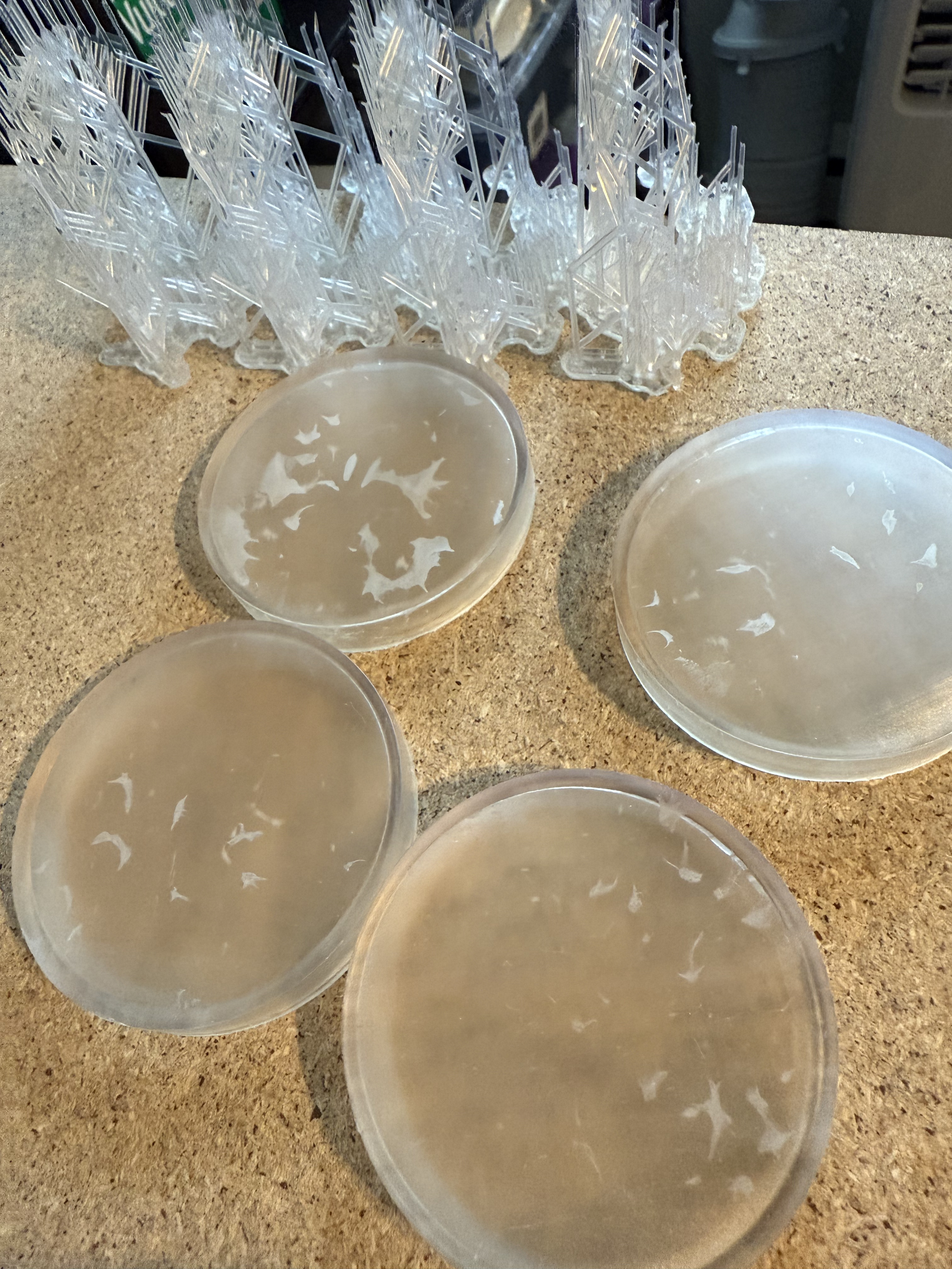

what could be causing these white marks on the clear resin?
there appears to be non on the support material, only the actual model.
printed on 4L
washed in wash L with TPM
3 min ultrasonic rinse.
30c water with a drop of dishwasher soap
i had a mild fan blowing at them to speed up dry before UV cure
I did have the degas option on the ultrasonic cleaner, would that have caused that?
Does anyone accurate times and settings for an ultra sonic cleaner rinse?
