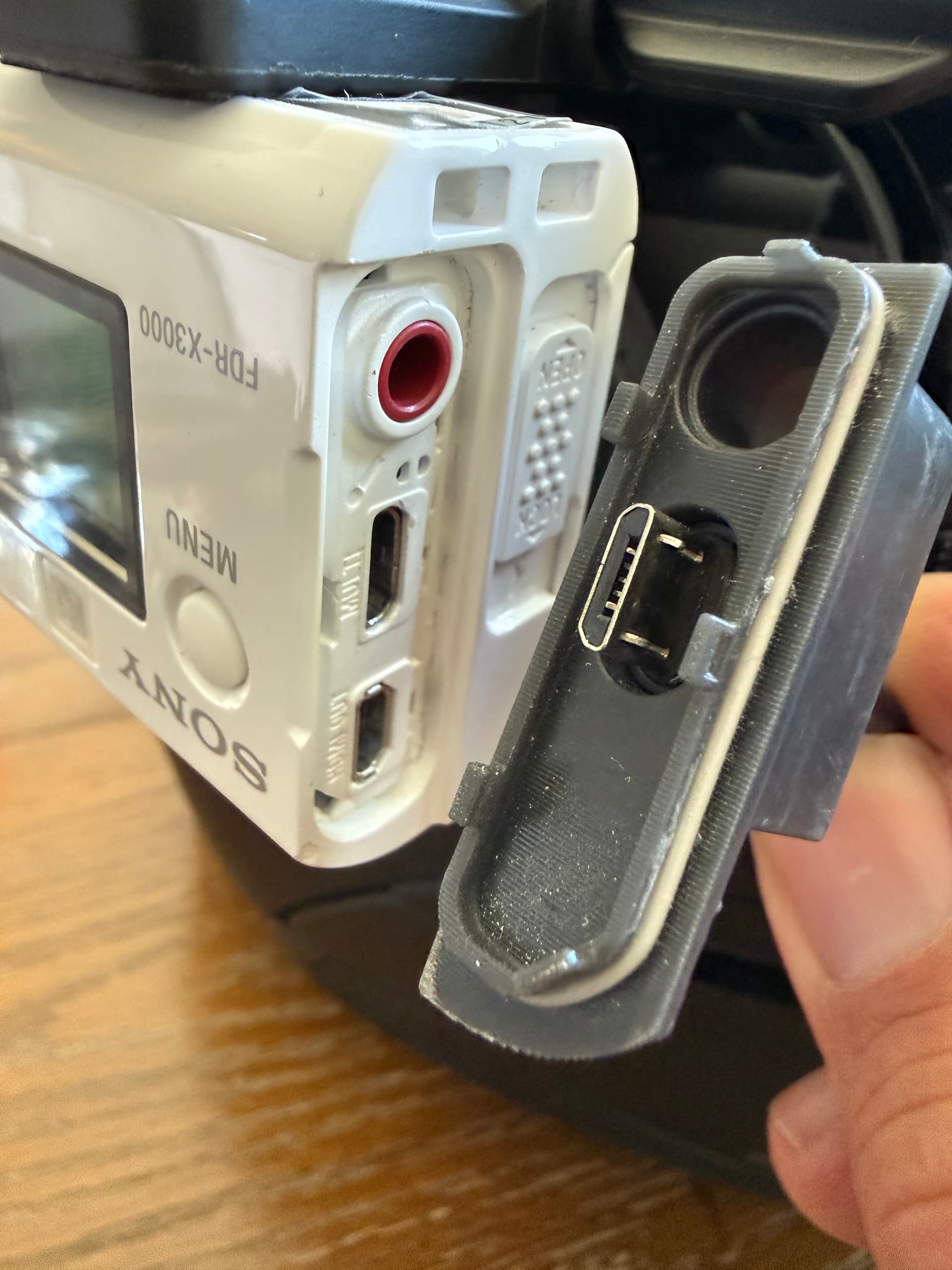

Back of the FDRx3000 and the audio jack and micro USB port. I needed to design a water/splash tight enclosure that used the existing latch points (?) and rubber gasket. It needed to be an enclosure that I could pot later to prevent any vibrations or bending of the input connections, which other FDR users have mentioned in the past as an issue when using external power supply when riding.

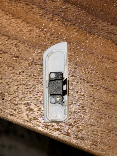

The OEM door that seals the input board. This is not submersible, but is splash proof against rain. I needed to replicate the design for my housing.

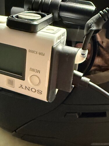

After many prototypes in Black V5 (not pictured), I finally had a functional prototype printed in Tough 1500. Notice how small the tabs are - 1mm x 3mm. These tabs help align the cover and help secure it to the main body. Along with the cables plugged in, which help hold the cover in place, the connection is quite sturdy and secure, although I believe some tweaking could be done to add a little more friction fit. After many, many cycles of installing and removing - tabs show no sign of wear, brittleness, or cracking. Wow.

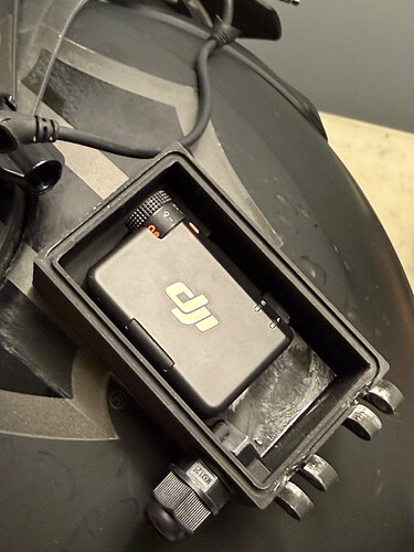

I’ve hit my current cap for design with waterproof enclosures - tolerances between body and lid keeps kicking my but. This was my first stab at hinges, I didn’t have the axis up high enough, and forgot to rib properly, so the hinges snapped off the lid. The back of the enclosure is curved to the form of the helmet, however the rest of the enclosure is just too bulky - my goal is to reduce the weigh and size of this, but it’s definitely kicking my butt at the moment. This one is still a work in progress. Printed in Black V5. One note about Black V5 is the resin chalks in friction zones, which helps out tremendously in prototyping as I can easily see where my CAD model needs to be adjusted.

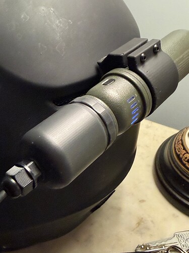

Making the power supply water proof. I’m using the NestOut 5000mAH power bank, which has a threaded end (for other accessories), however it does not have anything to waterproof a standard USB cable. I set out to change that. A simple threaded cylinder on one end, and a cable gland on the other end makes the fitment very waterproof. This is also printed in Tough 1500.

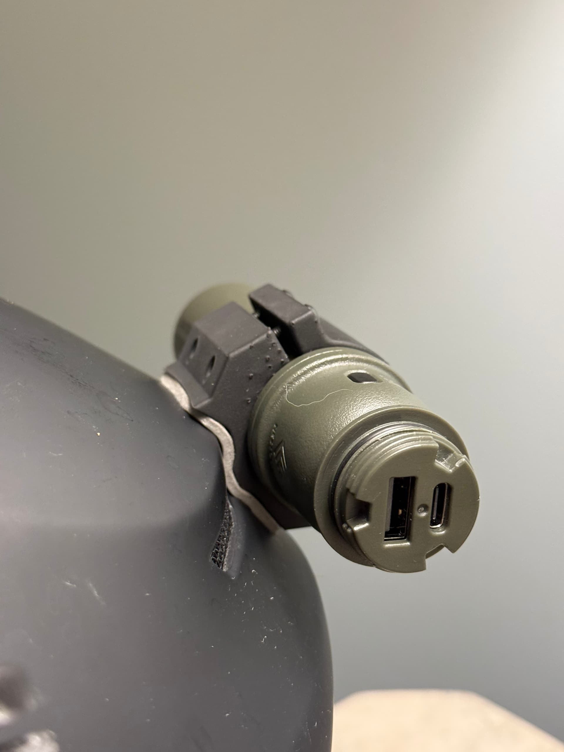

I also needed a way to secure the power bank to my motorcycle helmet at the rear. Importing the 3D scan took the longest here, but only because of my lack of practice with that workflow (mesh conversion). The battery mount is contoured to the back of the helmet to maximize surface contact for a solid hold, and is held using 3M double sided trim tape. A simple clamp design, held with 3mm bolts. No nuts, just threaded into the resin. I will eventually add slots to hold nuts, this was the first prototype print.
