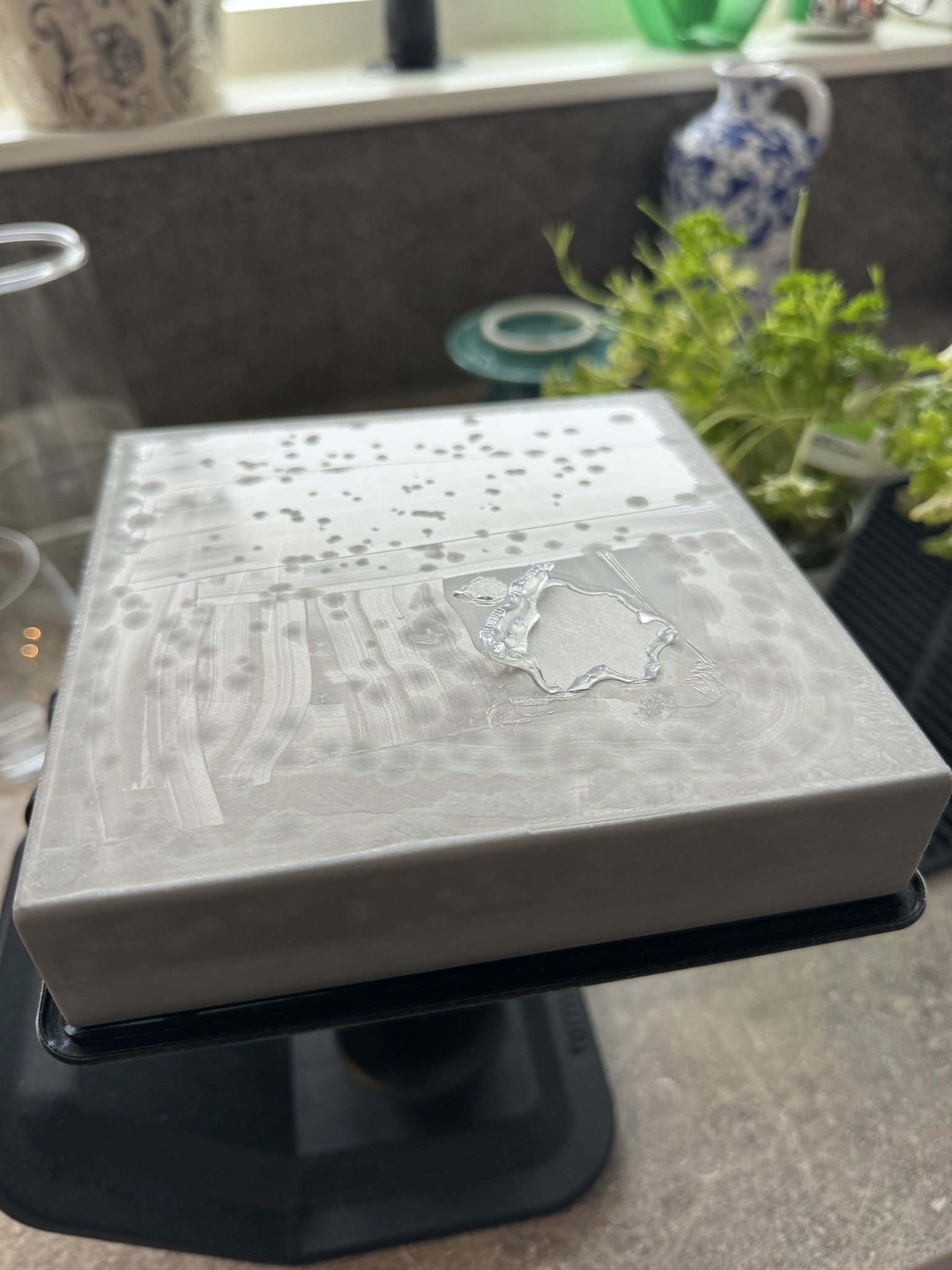

To test I printed another object but this time in Clear v4 and took old an advice from here too freeze the build plate, expectation was for the object to come loose of it own to very easily. I had it in the freezer for around 3h and let me tell you, it didn’t come loose very easily!
This is how it turned out.
So two resins stick abnormally good all of a sudden, with no change of build plate. Feels like it might be firmware related?
