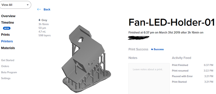

Ben:
By worse, I mean longer than Preform’s original printing estimate. In the past I always added 30-minutes to the estimate to account for tank heating, etc. Now it seems to be on the order of 60-minutes I need to add to the estimate. I’ve included the last item I printed (prior to latest firmware and Preform releases), a screen shot of the dashboard, and Preform’s (release 3.x) estimate.Fan-LED-Holder-01.form (778.5 KB)

We’ll investigate. Thanks.
In the upcoming Preform 3.0.2 release, we’ve made some improvements in print time estimation.
We’re looking forward to hearing back from you all about the accuracy of Preform’s estimates in the new release.
