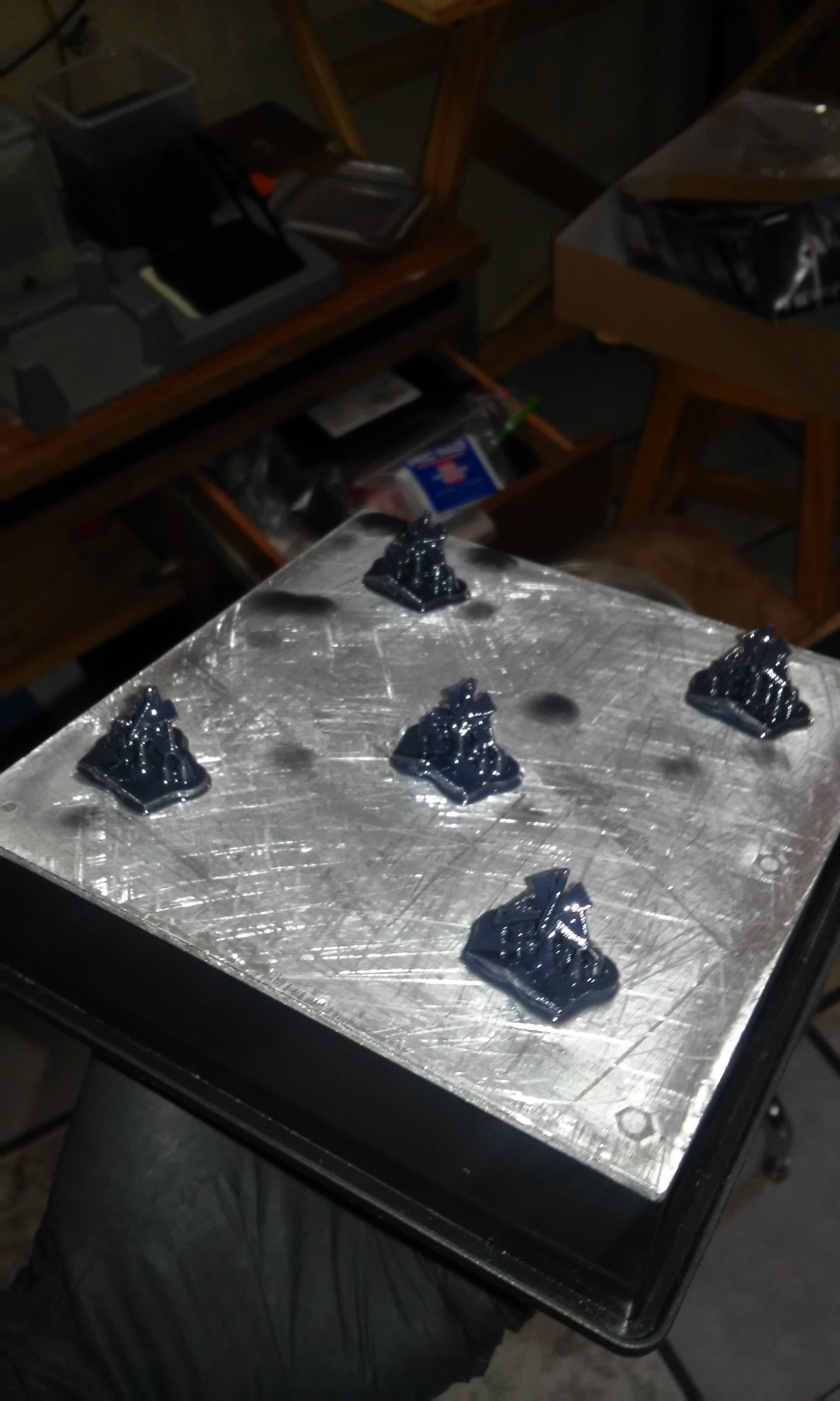

Tired, I tried the test clip, but I did a little change. I noticed smaller prints that didn’t go much up in height actually gave good results. (fittings and joints for the toy I’m trying to prototype worked perfectly). I tried the clips in a smaller scale:

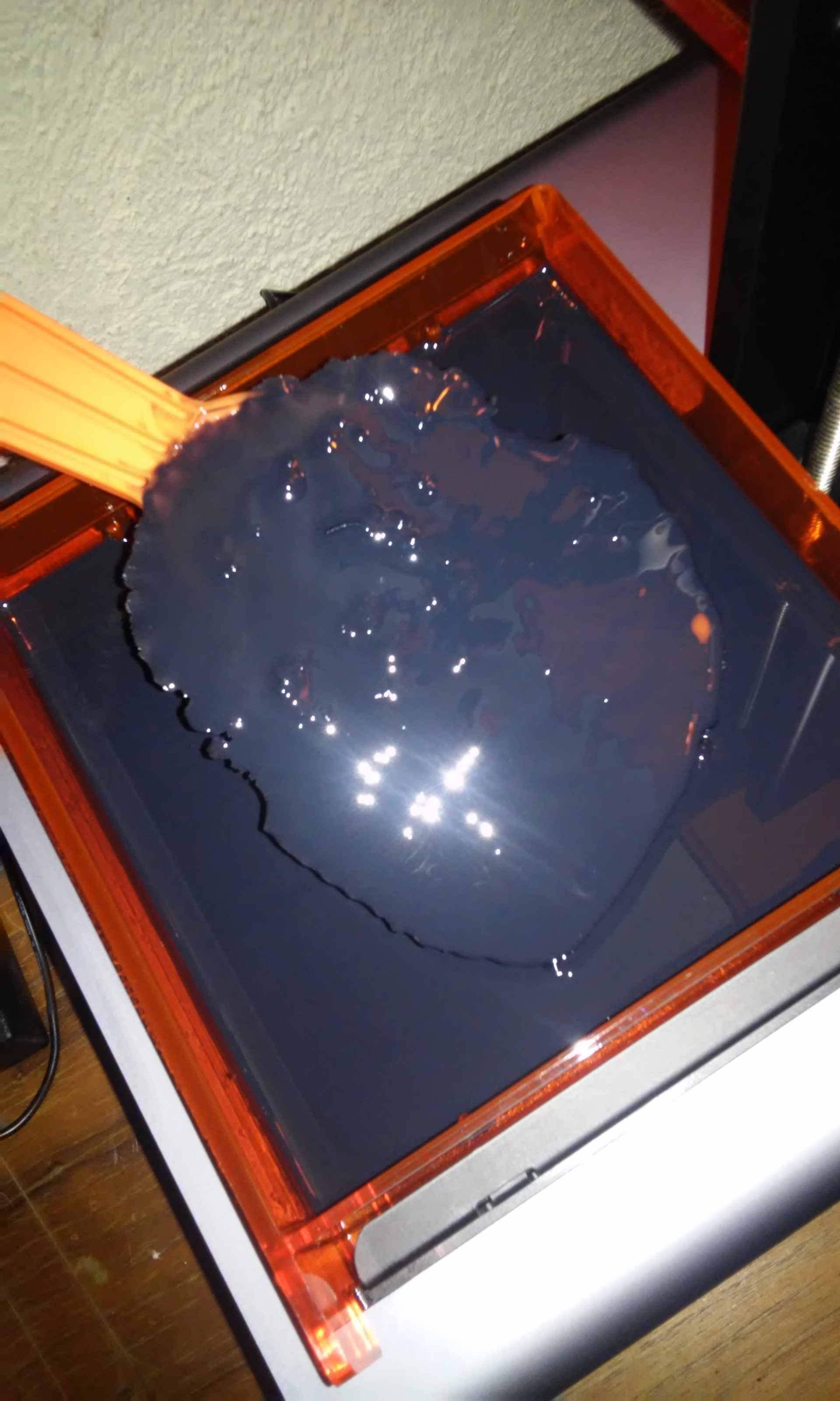

PERFECT print. And I spread these through the bed to test. I cleaned the resin tray as it is customary… To find a Strange Gooey layer; almost half- catalyzed. I filtered all the resin. You can see some of the collected goo (looked so much scary on the tank) on the filter.

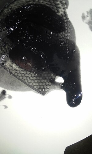

Alright. Resin filtered. Printer Super-cleaned. Hopeful, managed to try it again with the head. Silly me.
Well, an amazing failure.

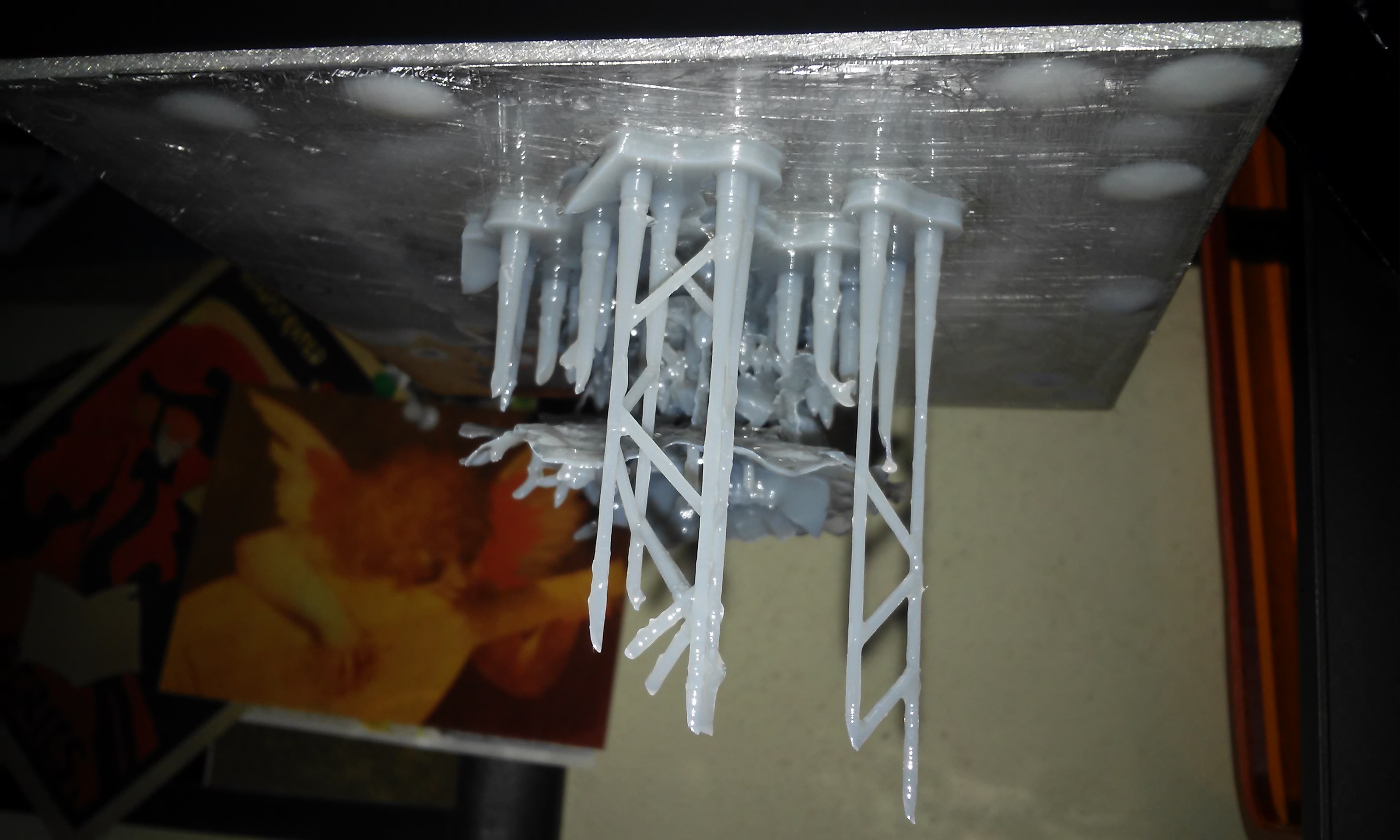

I’m trying again now with the gray resin that worked some days ago, hoping for better results. Maybe that way I’ll know if it’s something to do with the resin. If anyone here’s got ideas, I’ll be very glad to hear them since I’m to be honest: Dismayed.

Well… tank looks fine (Last tank just looks clouded. I’m a bit bitter since the things are expensive and it really didn’t manage to go a long way it seems) I just switched tanks to the one I have for gray resin. that one worked perfectly a couple days ago. Got this:
Officially, it’s major trouble now.
