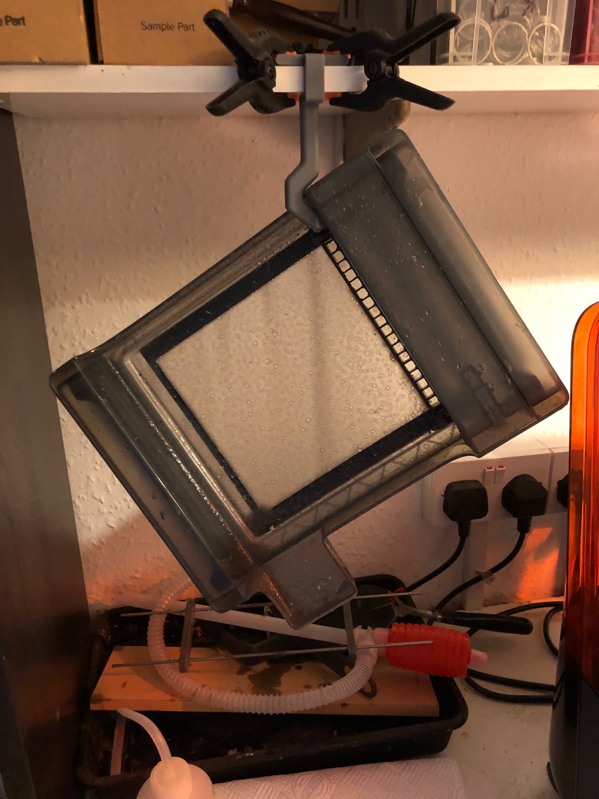

Hi bolsoncerrado
I made myself a hook:
Which holds a tray so that it drains into a pot:
As for heating the resin, I have an A4 sized 14watt heating pad which fits under the Form3 and keeps the resin in the tray at ~28-29ºC. This I find warm enough to filter the resin resonably quickly.
