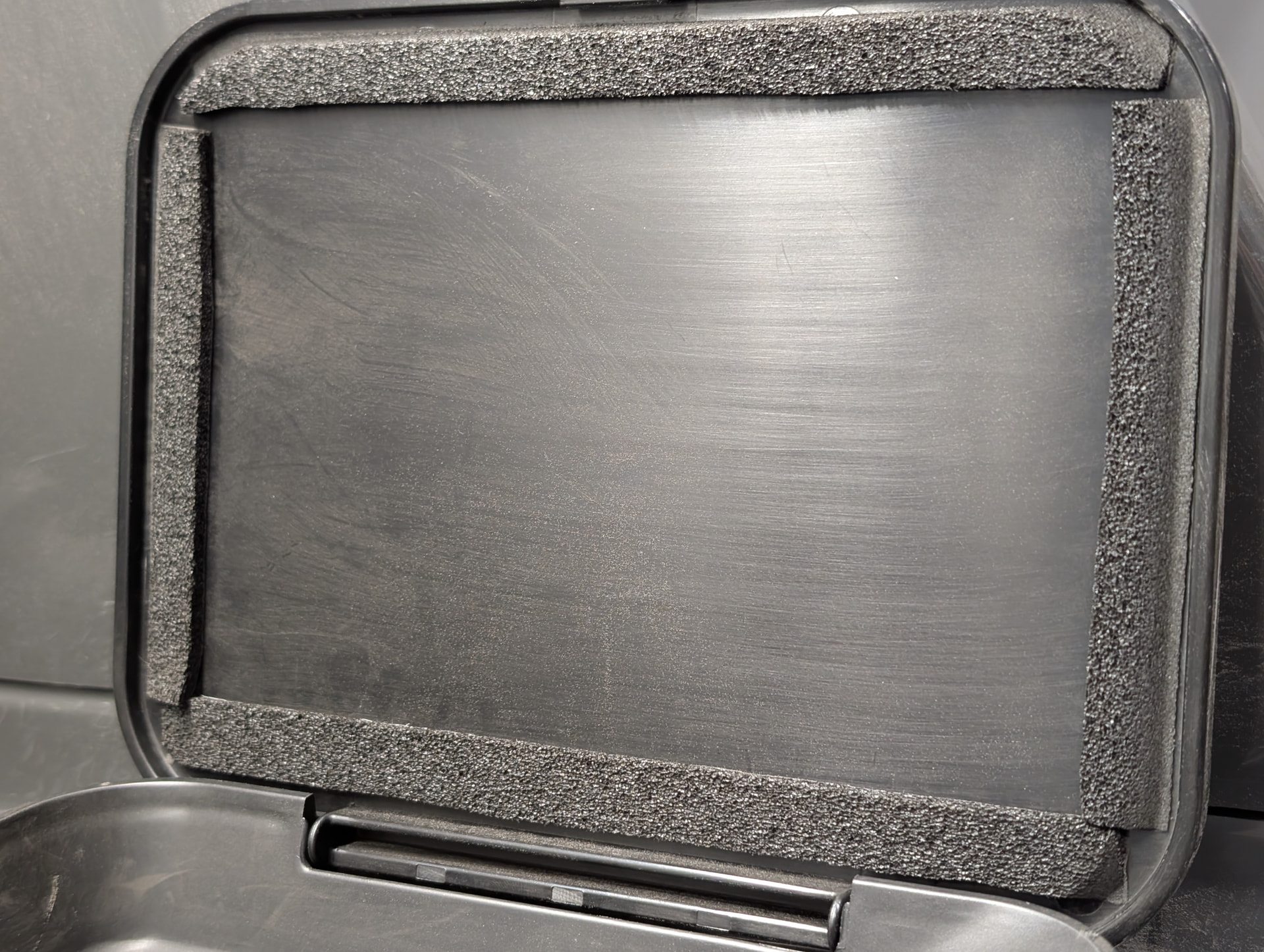

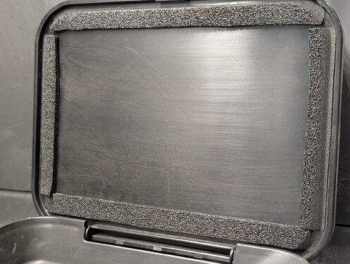

I was also concerned about the tolerances in the flippy flappy funnel lid, so the first thing I did was apply foam weather stripping to the perimeter of lid. It is not perfect but it is better than stock.

Yours looks different to mine. Mine is made from Nylon PA12. Good idea on the foam. Yes those hopper sensors especially the waste one. Thanks for replying.
Mine is molded. You should be able to request the first free one with the first bag order.
