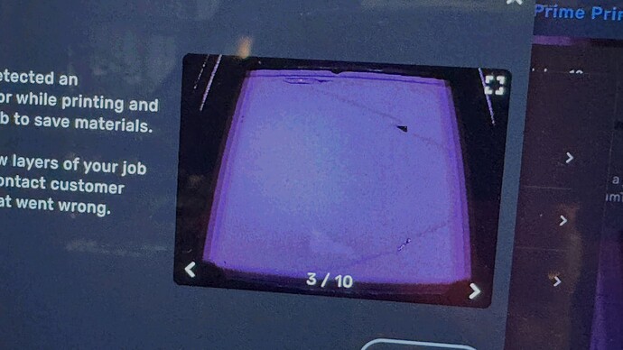

She is down again but I'm guessing why
No. You get no identification at all. Other than chambers start dumping powder and under dosing.
I spent a month troubleshooting chambers last time this happened till they mentioned that motor coupler…at least now I know and this time it only took a week of down time as I knew immediately.
Getting quite good at pulling the back of the Fuse apart…

do you always get the sink hole on the same area of the chamber?
I am assuming that somehow it is shifting the roller assembly diagonally, pushing a majority of the powder to the front side of the chamber, which overflows the left hand flipper on the front side but causing under dosing on the rear side. Does that match with the symptoms you see?
Happens on all sides.
