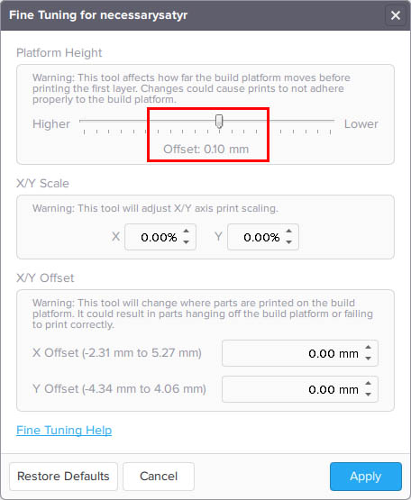

When you have adherence problems, one of the reasons is the build plate is not close enough to the PDMS surface.
Try reducing the distance by fine tuning the printer: In the file menu, click “Printers…”, then on the pop-up window click the name of the printer. A few options come up, co click on “Fine Tuning”.
To bring the platform closer to the PDMS surface, move the slider in the "Lower" direction. You can do this in increments of 0.1mm, up to 1mm. Start small and try printing again. If you get too close, then the bases will be very thin, and hard to get off, so somewhere in there you’ll find a happy medium.
This only works if the printer is connected by USB. Otherwise it can be accessed through the settings menu on the printer.

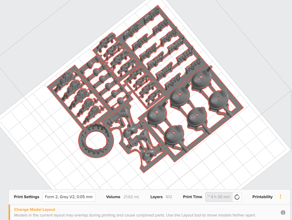

I’m on my iPad so I can’t see the .form file, but I have started making larger rafts or moving smaller models so they overlap with other small models’ rafts to make larger rafts if they are not sticking. Does that make sense? Preform will show the models in red and balk at you and tell you that they’re overlapped…but just override. Since I’m making jewelry, I’ll usually “gang” three models so there are three on one raft to make the raft larger.

I have also adjusted my vertical (Z-Axis?) setting through the touchscreen…add my vote to that option.
I’ve done the same many times, but never had Preform complain that the bases were overlapped. Maybe it’s the newer versions of PreForm, I’m still running 2.10.3, which is a year old, but works perfectly for me.
I checked tonight…I’m using a -0.2mm setting on the Z Fine Tuning…that’s a NEGATIVE 0.2mm. Just FYI.

I guess it doesn’t “balk,” but it does show all the models outlined in red and it says that there’s a problem with overlapping. I’m used to bypassing warnings…just livin’ on the edge with little CurlyBee!
